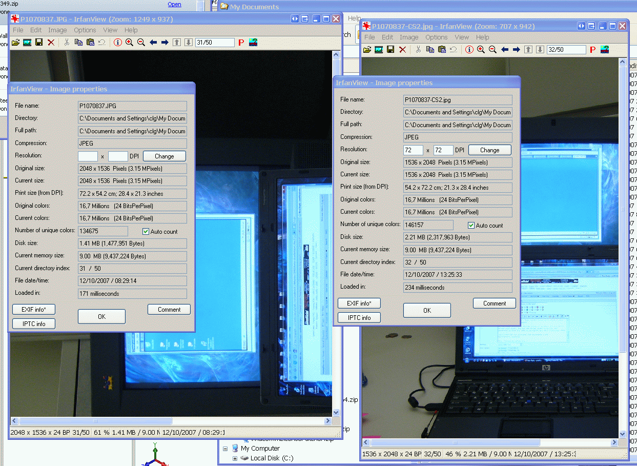

Tony, I did the following: Opened original file with Irfanview 3.98. Chose 'Image:Information'
Opened original in Photoshop CS2 (opened correctly in portrait mode). Saved as <>_cs2.jpg. Opened this copy in Irfanview.
My results: Original file - opened with computer monitor sideways in Irfan 3.98. Edited file - opened with computer monitor rightways round in Irfan 3.98.
File information in Irfan 3.98- shows the original at 2048x1536. shows the edited copy at 1536x2048. (as does CS2)
Exif data in both files was identical (See attached tab-delimited .txt file).
That leaves this question: what tag does CS2 use to tell orientation that Irfanview 3.98 and iTunes ignore?
-Zeke
EDIT: I got Irfanview 4.1 and had the same orientation results as 3.98 (opened original in landscape, re-saved copy in portrait)
tony_file_comparo.txt (391 downloads)Tony_File_Comparo.gif (324 downloads)
Edited by Ezekiel (10/12/2007 17:01) Edit Reason: updated
WWFSMD?
#304949 - 10/12/2007 17:02
Re: Syncing photos to ipod- Is there a better way?
[Re: Ezekiel]
Posts: 14530
This is the EXIF data of the original file:
File Type = JPEG
File Size = 1477951
@000000000=0 : <JPEG_SOI>
@0x0000002=2 : <JPEG_APP1> 0xffe1 length 27294, 'Exif'
@0x000000c=12 : TIFF(II=0x4949) magic=0x002a='*\0' ifd offset = 8 (+ 12 = 0x14/20)
@0x0000014=20 : <IFD 0> 11 entries starting at file offset 0x16=22
@0x0000016=22 : <0x010f= 271> Make [2 =ASCII 10] = @0x9e=158
@0x0000022=34 : <0x0110= 272> Model [2 =ASCII 8] = @0xa8=168
@0x000002e=46 : <0x0112= 274> Orientation [3 =SHORT 1] = 6 = '0,0 is right top'
@0x000003a=58 : <0x011a= 282> XResolution [5 =RATIONAL 1] = @0xb0=176
@0x0000046=70 : <0x011b= 283> YResolution [5 =RATIONAL 1] = @0xb8=184
@0x0000052=82 : <0x0128= 296> ResolutionUnit [3 =SHORT 1] = 2 = 'pixels per inch'
@0x000005e=94 : <0x0131= 305> Software [2 =ASCII 10] = @0xc0=192
@0x000006a=106 : <0x0132= 306> DateTime [2 =ASCII 20] = @0xca=202
@0x0000076=118 : <0x0213= 531> YCbCrPositioning [3 =SHORT 1] = 2 = 'co-sited'
@0x0000082=130 : <0x8769=34665> ExifIFDPointer [4 =LONG 1] = @0x1ae=430
@0x000008e=142 : <0xc4a5=50341> PrintIM [7 =UNDEFINED 208] = @0xde=222
@0x000009a=154 : **** next IFD offset 6682(+ 12 = 0x1a26/6694)

@0x000021c=540 : <0x9204=37380> ExposureBiasValue [10=SRATIONAL 1] = @0x38c=908
@0x0000228=552 : <0x9205=37381> MaxApertureValue [5 =RATIONAL 1] = @0x394=916
@0x0000234=564 : <0x9207=37383> MeteringMode [3 =SHORT 1] = 5 = 'Pattern'
@0x0000240=576 : <0x9208=37384> LightSource [3 =SHORT 1] = 0 = 'unknown'
@0x000024c=588 : <0x9209=37385> Flash [3 =SHORT 1] = 16 = 'no flash - suppressed'
@0x0000258=600 : <0x920a=37386> FocalLength [5 =RATIONAL 1] = @0x39c=924
@0x0000264=612 : <0x927c=37500> MakerNote [7 =UNDEFINED 5724] = @0x3a4=932
@0x0000270=624 : <0xa000=40960> FlashPixVersion [7 =UNDEFINED 4] = '0100'
@0x000027c=636 : <0xa001=40961> ColorSpace [3 =SHORT 1] = 1 = 'sRGB'
@0x0000288=648 : <0xa002=40962> PixelXDimension [4 =LONG 1] = 2048
@0x0000294=660 : <0xa003=40963> PixelYDimension [4 =LONG 1] = 1536
@0x00002a0=672 : <0xa005=40965> Interoperability [4 =LONG 1] = @0x1a08=6664
@0x00002ac=684 : <0xa217=41495> SensingMethod [3 =SHORT 1] = 2 = 'One-chip color area sensor'
@0x00002b8=696 : <0xa300=41728> FileSource [7 =UNDEFINED 1] = 3 = 'DSC'
@0x00002c4=708 : <0xa301=41729> SceneType [7 =UNDEFINED 1] = 1 = 'direct photo'
@0x00002d0=720 : <0xa401=41985> CustomRendered [3 =SHORT 1] = 0 = 'Normal'
@0x00002dc=732 : <0xa402=41986> ExposureMode [3 =SHORT 1] = 0 = 'Auto'
@0x00002e8=744 : <0xa403=41987> WhiteBalance [3 =SHORT 1] = 1 = 'Manual'
@0x00002f4=756 : <0xa404=41988> DigitalZoomRatio [5 =RATIONAL 1] = @0x1a00=6656
@0x0000300=768 : <0xa405=41989> FocalLengthIn35mmFilm [3 =SHORT 1] = 35mm
@0x000030c=780 : <0xa406=41990> SceneCaptureType [3 =SHORT 1] = 0 = 'Standard'
@0x0000318=792 : <0xa407=41991> GainControl [3 =SHORT 1] = 0 = 'None'
@0x0000324=804 : <0xa408=41992> Contrast [3 =SHORT 1] = 0 = 'Normal'
@0x0000330=816 : <0xa409=41993> Saturation [3 =SHORT 1] = 0 = 'Normal'
@0x000033c=828 : <0xa40a=41994> Sharpness [3 =SHORT 1] = 0 = 'Normal'
@0x0000348=840 : **** next IFD offset 0
@0x000034c=844 : ============= VALUES, EXIF IFD ============
@0x000034c=844 : ExposureTime = 0.05 sec
@0x0000354=852 : FNumber = 2.8 APEX = 'f2.6'
@0x000035c=860 : DateTimeOriginal = '2007:12:10 08:29:13\0'
@0x0000370=880 : DateTimeDigitized = '2007:12:10 08:29:13\0'
@0x0000384=900 : CompressedBitsPerPixel = 4
@0x000038c=908 : ExposureBiasValue = 0 APEX
@0x0000394=916 : MaxApertureValue = 3 APEX = 'f2.8'
@0x000039c=924 : FocalLength = 5.8 mm
@0x00003a4=932 : <MakerNote> length 5724, ID scheme, 30 entries starting at offset 0x3b2/946
@0x00003a4=932 : MakerNoteId = 'Panasonic'
@0x00003b2=946 : <0X0001= 1> Quality [ 3=SHORT 1] = 2 = 'Fine'
@0x00003be=958 : <0X0002= 2> TAG_0X0002 [ 7=UNDEFINED 4] = 0,1,0,3
@0x00003ca=970 : <0X0003= 3> WhiteBalance [ 3=SHORT 1] = 5 = 'Manual'
@0x00003d6=982 : <0X0007= 7> FocusMode [ 3=SHORT 1] = 1 = 'Auto'
@0x00003e2=994 : <0X000F= 15> SpotMode [ 1=BYTE 2] = 1,0 = 'Spot'
@0x00003ee=1006 : <0X001A= 26> StabilizerMode [ 3=SHORT 1] = 2 = 'Mode 1'
@0x00003fa=1018 : <0X001C= 28> Macro [ 3=SHORT 1] = 2 = 'Off'
@0x0000406=1030 : <0X001F= 31> PictureMode [ 3=SHORT 1] = 1 = 'undefined'
@0x0000412=1042 : <0X0020= 32> Audio [ 3=SHORT 1] = 2 = 'No'
@0x000041e=1054 : <0X0021= 33> TAG_0X0021 [ 7=UNDEFINED 5314] = @0x51a=1306
@0x000042a=1066 : <0X0022= 34> TAG_0X0022 [ 3=SHORT 1] = 0
@0x0000436=1078 : <0X0023= 35> WhiteBalanceAdjust [ 3=SHORT 1] = 0 = '0'
@0x0000442=1090 : <0X0024= 36> FlashStrength [ 3=SHORT 1] = 0 = '0 EV'
@0x000044e=1102 : <0X0025= 37> TAG_0X0025 [ 7=UNDEFINED 16] = @0x19dc=6620
@0x000045a=1114 : <0X0026= 38> TAG_0X0026 [ 7=UNDEFINED 4] = 48,49,48,52 = '0104'
@0x0000466=1126 : <0X0027= 39> TAG_0X0027 [ 3=SHORT 1] = 0
@0x0000472=1138 : <0X0028= 40> ColorMode [ 3=SHORT 1] = 1 = 'Off'
@0x000047e=1150 : <0X0029= 41> TAG_0X0029 [ 4=LONG 1] = 5809
@0x000048a=1162 : <0X002A= 42> TAG_0X002A [ 3=SHORT 1] = 4
@0x0000496=1174 : <0X002B= 43> TAG_0X002B [ 4=LONG 1] = 1
@0x00004a2=1186 : <0X002C= 44> Contrast [ 3=SHORT 1] = 0 = 'Standard'
@0x00004ae=1198 : <0X002D= 45> NoiseReduction [ 3=SHORT 1] = 0 = 'Standard'
@0x00004ba=1210 : <0X002E= 46> TAG_0X002E [ 3=SHORT 1] = 1
@0x00004c6=1222 : <0X002F= 47> TAG_0X002F [ 3=SHORT 1] = 1
@0x00004d2=1234 : <0X0030= 48> TAG_0X0030 [ 3=SHORT 1] = 6
@0x00004de=1246 : <0X0031= 49> TAG_0X0031 [ 3=SHORT 1] = 2
@0x00004ea=1258 : <0X0032= 50> TAG_0X0032 [ 3=SHORT 1] = 0
@0x00004f6=1270 : <0X0033= 51> TAG_0X0033 [ 2=ASCII 20] = @0x19ec=6636
@0x0000502=1282 : <0X0034= 52> TAG_0X0034 [ 3=SHORT 1] = 1
@0x000050e=1294 : <0X0035= 53> TAG_0X0035 [ 3=SHORT 1] = 1
@0x000051a=1306 : no next IFD offset used
@0x000051a=1306 : ============= VALUES, MakerNote ============
@0x000051a=1306 : TAG_0X0021 : length 5314 # UNDEFINED (not dumped, use -U)
@0x00019dc=6620 : TAG_0X0025 : length 16 # UNDEFINED (not dumped, use -U)
@0x00019ec=6636 : TAG_0X0033 = '9999:99:99 00:00:00\0'
@0x00019ff=6655 : </MakerNote>
@0x0001a08=6664 : <Interoperability SubIFD> 2 entries starting at file offset 0x1a0a=6666
@0x0001a0a=6666 : <0x0001= 1> InteroperabilityIndex [2 =ASCII 4] = 'R98'
@0x0001a16=6678 : <0x0002= 2> InteroperabilityVersion [7 =UNDEFINED 4] = '0100'
@0x0001a22=6690 : **** next IFD offset 0
@0x0001a25=6693 : </Interoperability SubIFD>
@0x0001a00=6656 : DigitalZoomRatio = 0
-0x0001a25=6693 : </EXIF IFD>
@0x00000de=222 : <PrintIM> Version 0250, size 208, 14 entries
@0x00000ee=238 : PIM_0X0001 = 16 00 16 00 |....| = 0x160016/1441814
@0x00000f4=244 : PIM_0X0002 = 00 00 00 00 |....| = 0/0
@0x00000fa=250 : PIM_0X0003 = 64 00 00 00 |d...| = 0x64/100
@0x0000100=256 : PIM_0X0007 = 00 00 00 00 |....| = 0/0
@0x0000106=262 : PIM_0X0008 = 00 00 00 00 |....| = 0/0
@0x000010c=268 : PIM_0X0009 = 00 00 00 00 |....| = 0/0
@0x0000112=274 : PIM_0X000A = 00 00 00 00 |....| = 0/0
@0x0000118=280 : PIM_0X000B = ac 00 00 00 |....| = 0xac/172
@0x000011e=286 : PIM_0X000C = 00 00 00 00 |....| = 0/0
@0x0000124=292 : PIM_0X000D = 00 00 00 00 |....| = 0/0
@0x000012a=298 : PIM_0X000E = c4 00 00 00 |....| = 0xc4/196
@0x0000130=304 : PIM_0X0100 = 05 00 00 00 |....| = 0x5/5
@0x0000136=310 : PIM_0X0101 = 01 00 00 00 |....| = 0x1/1
@0x000013c=316 : PIM_0X0110 = 80 00 00 00 |....| = 0x80/128
*0x0000142=322 : ---- End of values before end of PrintIM section
-0x00001ad=429 : </PrintIM>
@0x0001a25=6693 : </IFD 0>
@0x0001a26=6694 : <IFD 1> 8 entries starting at file offset 0x1a28=6696
@0x0001a28=6696 : <0x0103= 259> Compression [3 =SHORT 1] = 6 = 'Exif/old JPEG'
@0x0001a34=6708 : <0x0112= 274> Orientation [3 =SHORT 1] = 6 = '0,0 is right top'
@0x0001a40=6720 : <0x011a= 282> XResolution [5 =RATIONAL 1] = @0x1a8c=6796
@0x0001a4c=6732 : <0x011b= 283> YResolution [5 =RATIONAL 1] = @0x1a94=6804
@0x0001a58=6744 : <0x0128= 296> ResolutionUnit [3 =SHORT 1] = 2 = 'pixels per inch'
@0x0001a64=6756 : <0x0201= 513> JPEGInterchangeFormat [4 =LONG 1] = @0x1aa0=6816
@0x0001a70=6768 : <0x0202= 514> JPEGInterchangeFormatLength [4 =LONG 1] = 5502
@0x0001a7c=6780 : <0x0213= 531> YCbCrPositioning [3 =SHORT 1] = 2 = 'co-sited'
@0x0001a88=6792 : **** next IFD offset 0
@0x0001a8c=6796 : ============= VALUES, IFD 1 ============
@0x0001a8c=6796 : XResolution = 72
@0x0001a94=6804 : YResolution = 72
@0x0001aa0=6816 : #### Start of JPEG thumbnail data for IFD 1, length 5502 ####
@0x0001aa0=6816 : <JPEG_SOI>
@0x0001aa2=6818 : <JPEG_DQT> length 132
@0x0001b28=6952 : <JPEG_SOF_0> length 17, 8 bits/sample, components=3, width=160, height=120
@0x0001b3b=6971 : <JPEG_DHT> length 418 table class = 0 table id = 0
@0x0001cdf=7391 : <JPEG_SOS> length 12 start of JPEG data, 3 components 19200 pixels
@0x000301c=12316 : <JPEG_EOI> JPEG length 5502
@0x000301d=12317 : #### End of JPEG thumbnail data for IFD 1, length 5502 ####
@0x000301d=12317 : </IFD 1>
-0x0006aa1=27297 : </JPEG_APP1>
@0x0006aa2=27298 : <JPEG_DQT> length 132
@0x0006b28=27432 : <JPEG_SOF_0> length 17, 8 bits/sample, components=3, width=2048, height=1536
@0x0006b3b=27451 : <JPEG_DHT> length 418 table class = 0 table id = 0
@0x0006cdf=27871 : <JPEG_DRI> length 4
@0x0006ce5=27877 : <JPEG_SOS> length 12 start of JPEG data, 3 components 3145728 pixels
@0x0168d3d=1477949 : <JPEG_EOI> JPEG length 1477951
-0x0168d3e=1477950 : END OF FILE
@000000000=0 : Start of JPEG baseline DCT compressed primary image [2048x1536] length 1477951
-0x0168d3e=1477950 : End of JPEG primary image data
@0x0001aa0=6816 : Start of JPEG baseline DCT compressed reduced-resolution image [160x120] length 5502 (IFD 1)
-0x000301d=12317 : End of JPEG reduced-resolution image data
Number of images = 2
File Format = JPEG/APP1/TIFF/EXIF # with MakerNote (Panasonic [1])
#304951 - 10/12/2007 17:03
Posts: 14530
Hmmm.. that teensy tiny scroll box is useless, so here's the EXIF data again, without the [code] tag:
File Name = p1070837.jpg File Type = JPEG File Size = 1477951 @000000000=0 : <JPEG_SOI> @0x0000002=2 : <JPEG_APP1> 0xffe1 length 27294, 'Exif' @0x000000c=12 : TIFF(II=0x4949) magic=0x002a='*\0' ifd offset = 8 (+ 12 = 0x14/20) @0x0000014=20 : <IFD 0> 11 entries starting at file offset 0x16=22 @0x0000016=22 : <0x010f= 271> Make [2 =ASCII 10] = @0x9e=158 @0x0000022=34 : <0x0110= 272> Model [2 =ASCII 8] = @0xa8=168 @0x000002e=46 : <0x0112= 274> Orientation [3 =SHORT 1] = 6 = '0,0 is right top' @0x000003a=58 : <0x011a= 282> XResolution [5 =RATIONAL 1] = @0xb0=176 @0x0000046=70 : <0x011b= 283> YResolution [5 =RATIONAL 1] = @0xb8=184 @0x0000052=82 : <0x0128= 296> ResolutionUnit [3 =SHORT 1] = 2 = 'pixels per inch' @0x000005e=94 : <0x0131= 305> Software [2 =ASCII 10] = @0xc0=192 @0x000006a=106 : <0x0132= 306> DateTime [2 =ASCII 20] = @0xca=202 @0x0000076=118 : <0x0213= 531> YCbCrPositioning [3 =SHORT 1] = 2 = 'co-sited' @0x0000082=130 : <0x8769=34665> ExifIFDPointer [4 =LONG 1] = @0x1ae=430 @0x000008e=142 : <0xc4a5=50341> PrintIM [7 =UNDEFINED 208] = @0xde=222 @0x000009a=154 : **** next IFD offset 6682(+ 12 = 0x1a26/6694) @0x000009e=158 : ============= VALUES, IFD 0 ============ @0x000009e=158 : Make = 'Panasonic\0' @0x00000a8=168 : Model = 'DMC-FX9\0' @0x00000b0=176 : XResolution = 72 @0x00000b8=184 : YResolution = 72 @0x00000c0=192 : Software = 'Ver.1.0 \0' @0x00000ca=202 : DateTime = '2007:12:10 08:29:13\0' @0x00001ae=430 : <EXIF IFD> (in IFD 0) 34 entries starting at file offset 0x1b0=432 @0x00001b0=432 : <0x829a=33434> ExposureTime [5 =RATIONAL 1] = @0x34c=844 @0x00001bc=444 : <0x829d=33437> FNumber [5 =RATIONAL 1] = @0x354=852 @0x00001c8=456 : <0x8822=34850> ExposureProgram [3 =SHORT 1] = 2 = 'Normal' @0x00001d4=468 : <0x8827=34855> ISOSpeedRatings [3 =SHORT 1] = 100 @0x00001e0=480 : <0x9000=36864> Version [7 =UNDEFINED 4] = '0220' @0x00001ec=492 : <0x9003=36867> DateTimeOriginal [2 =ASCII 20] = @0x35c=860 @0x00001f8=504 : <0x9004=36868> DateTimeDigitized [2 =ASCII 20] = @0x370=880 @0x0000204=516 : <0x9101=37121> ComponentsConfiguration [7 =UNDEFINED 4] = 1,2,3,0 = 'YCbCr' @0x0000210=528 : <0x9102=37122> CompressedBitsPerPixel [5 =RATIONAL 1] = @0x384=900 @0x000021c=540 : <0x9204=37380> ExposureBiasValue [10=SRATIONAL 1] = @0x38c=908 @0x0000228=552 : <0x9205=37381> MaxApertureValue [5 =RATIONAL 1] = @0x394=916 @0x0000234=564 : <0x9207=37383> MeteringMode [3 =SHORT 1] = 5 = 'Pattern' @0x0000240=576 : <0x9208=37384> LightSource [3 =SHORT 1] = 0 = 'unknown' @0x000024c=588 : <0x9209=37385> Flash [3 =SHORT 1] = 16 = 'no flash - suppressed' @0x0000258=600 : <0x920a=37386> FocalLength [5 =RATIONAL 1] = @0x39c=924 @0x0000264=612 : <0x927c=37500> MakerNote [7 =UNDEFINED 5724] = @0x3a4=932 @0x0000270=624 : <0xa000=40960> FlashPixVersion [7 =UNDEFINED 4] = '0100' @0x000027c=636 : <0xa001=40961> ColorSpace [3 =SHORT 1] = 1 = 'sRGB' @0x0000288=648 : <0xa002=40962> PixelXDimension [4 =LONG 1] = 2048 @0x0000294=660 : <0xa003=40963> PixelYDimension [4 =LONG 1] = 1536 @0x00002a0=672 : <0xa005=40965> Interoperability [4 =LONG 1] = @0x1a08=6664 @0x00002ac=684 : <0xa217=41495> SensingMethod [3 =SHORT 1] = 2 = 'One-chip color area sensor' @0x00002b8=696 : <0xa300=41728> FileSource [7 =UNDEFINED 1] = 3 = 'DSC' @0x00002c4=708 : <0xa301=41729> SceneType [7 =UNDEFINED 1] = 1 = 'direct photo' @0x00002d0=720 : <0xa401=41985> CustomRendered [3 =SHORT 1] = 0 = 'Normal' @0x00002dc=732 : <0xa402=41986> ExposureMode [3 =SHORT 1] = 0 = 'Auto' @0x00002e8=744 : <0xa403=41987> WhiteBalance [3 =SHORT 1] = 1 = 'Manual' @0x00002f4=756 : <0xa404=41988> DigitalZoomRatio [5 =RATIONAL 1] = @0x1a00=6656 @0x0000300=768 : <0xa405=41989> FocalLengthIn35mmFilm [3 =SHORT 1] = 35mm @0x000030c=780 : <0xa406=41990> SceneCaptureType [3 =SHORT 1] = 0 = 'Standard' @0x0000318=792 : <0xa407=41991> GainControl [3 =SHORT 1] = 0 = 'None' @0x0000324=804 : <0xa408=41992> Contrast [3 =SHORT 1] = 0 = 'Normal' @0x0000330=816 : <0xa409=41993> Saturation [3 =SHORT 1] = 0 = 'Normal' @0x000033c=828 : <0xa40a=41994> Sharpness [3 =SHORT 1] = 0 = 'Normal' @0x0000348=840 : **** next IFD offset 0 @0x000034c=844 : ============= VALUES, EXIF IFD ============ @0x000034c=844 : ExposureTime = 0.05 sec @0x0000354=852 : FNumber = 2.8 APEX = 'f2.6' @0x000035c=860 : DateTimeOriginal = '2007:12:10 08:29:13\0' @0x0000370=880 : DateTimeDigitized = '2007:12:10 08:29:13\0' @0x0000384=900 : CompressedBitsPerPixel = 4 @0x000038c=908 : ExposureBiasValue = 0 APEX @0x0000394=916 : MaxApertureValue = 3 APEX = 'f2.8' @0x000039c=924 : FocalLength = 5.8 mm @0x00003a4=932 : <MakerNote> length 5724, ID scheme, 30 entries starting at offset 0x3b2/946 @0x00003a4=932 : MakerNoteId = 'Panasonic' @0x00003b2=946 : <0X0001= 1> Quality [ 3=SHORT 1] = 2 = 'Fine' @0x00003be=958 : <0X0002= 2> TAG_0X0002 [ 7=UNDEFINED 4] = 0,1,0,3 @0x00003ca=970 : <0X0003= 3> WhiteBalance [ 3=SHORT 1] = 5 = 'Manual' @0x00003d6=982 : <0X0007= 7> FocusMode [ 3=SHORT 1] = 1 = 'Auto' @0x00003e2=994 : <0X000F= 15> SpotMode [ 1=BYTE 2] = 1,0 = 'Spot' @0x00003ee=1006 : <0X001A= 26> StabilizerMode [ 3=SHORT 1] = 2 = 'Mode 1' @0x00003fa=1018 : <0X001C= 28> Macro [ 3=SHORT 1] = 2 = 'Off' @0x0000406=1030 : <0X001F= 31> PictureMode [ 3=SHORT 1] = 1 = 'undefined' @0x0000412=1042 : <0X0020= 32> Audio [ 3=SHORT 1] = 2 = 'No' @0x000041e=1054 : <0X0021= 33> TAG_0X0021 [ 7=UNDEFINED 5314] = @0x51a=1306 @0x000042a=1066 : <0X0022= 34> TAG_0X0022 [ 3=SHORT 1] = 0 @0x0000436=1078 : <0X0023= 35> WhiteBalanceAdjust [ 3=SHORT 1] = 0 = '0' @0x0000442=1090 : <0X0024= 36> FlashStrength [ 3=SHORT 1] = 0 = '0 EV' @0x000044e=1102 : <0X0025= 37> TAG_0X0025 [ 7=UNDEFINED 16] = @0x19dc=6620 @0x000045a=1114 : <0X0026= 38> TAG_0X0026 [ 7=UNDEFINED 4] = 48,49,48,52 = '0104' @0x0000466=1126 : <0X0027= 39> TAG_0X0027 [ 3=SHORT 1] = 0 @0x0000472=1138 : <0X0028= 40> ColorMode [ 3=SHORT 1] = 1 = 'Off' @0x000047e=1150 : <0X0029= 41> TAG_0X0029 [ 4=LONG 1] = 5809 @0x000048a=1162 : <0X002A= 42> TAG_0X002A [ 3=SHORT 1] = 4 @0x0000496=1174 : <0X002B= 43> TAG_0X002B [ 4=LONG 1] = 1 @0x00004a2=1186 : <0X002C= 44> Contrast [ 3=SHORT 1] = 0 = 'Standard' @0x00004ae=1198 : <0X002D= 45> NoiseReduction [ 3=SHORT 1] = 0 = 'Standard' @0x00004ba=1210 : <0X002E= 46> TAG_0X002E [ 3=SHORT 1] = 1 @0x00004c6=1222 : <0X002F= 47> TAG_0X002F [ 3=SHORT 1] = 1 @0x00004d2=1234 : <0X0030= 48> TAG_0X0030 [ 3=SHORT 1] = 6 @0x00004de=1246 : <0X0031= 49> TAG_0X0031 [ 3=SHORT 1] = 2 @0x00004ea=1258 : <0X0032= 50> TAG_0X0032 [ 3=SHORT 1] = 0 @0x00004f6=1270 : <0X0033= 51> TAG_0X0033 [ 2=ASCII 20] = @0x19ec=6636 @0x0000502=1282 : <0X0034= 52> TAG_0X0034 [ 3=SHORT 1] = 1 @0x000050e=1294 : <0X0035= 53> TAG_0X0035 [ 3=SHORT 1] = 1 @0x000051a=1306 : no next IFD offset used @0x000051a=1306 : ============= VALUES, MakerNote ============ @0x000051a=1306 : TAG_0X0021 : length 5314 # UNDEFINED (not dumped, use -U) @0x00019dc=6620 : TAG_0X0025 : length 16 # UNDEFINED (not dumped, use -U) @0x00019ec=6636 : TAG_0X0033 = '9999:99:99 00:00:00\0' @0x00019ff=6655 : </MakerNote> @0x0001a08=6664 : <Interoperability SubIFD> 2 entries starting at file offset 0x1a0a=6666 @0x0001a0a=6666 : <0x0001= 1> InteroperabilityIndex [2 =ASCII 4] = 'R98' @0x0001a16=6678 : <0x0002= 2> InteroperabilityVersion [7 =UNDEFINED 4] = '0100' @0x0001a22=6690 : **** next IFD offset 0 @0x0001a25=6693 : </Interoperability SubIFD> @0x0001a00=6656 : DigitalZoomRatio = 0 -0x0001a25=6693 : </EXIF IFD> @0x00000de=222 : <PrintIM> Version 0250, size 208, 14 entries @0x00000ee=238 : PIM_0X0001 = 16 00 16 00 |....| = 0x160016/1441814 @0x00000f4=244 : PIM_0X0002 = 00 00 00 00 |....| = 0/0 @0x00000fa=250 : PIM_0X0003 = 64 00 00 00 |d...| = 0x64/100 @0x0000100=256 : PIM_0X0007 = 00 00 00 00 |....| = 0/0 @0x0000106=262 : PIM_0X0008 = 00 00 00 00 |....| = 0/0 @0x000010c=268 : PIM_0X0009 = 00 00 00 00 |....| = 0/0 @0x0000112=274 : PIM_0X000A = 00 00 00 00 |....| = 0/0 @0x0000118=280 : PIM_0X000B = ac 00 00 00 |....| = 0xac/172 @0x000011e=286 : PIM_0X000C = 00 00 00 00 |....| = 0/0 @0x0000124=292 : PIM_0X000D = 00 00 00 00 |....| = 0/0 @0x000012a=298 : PIM_0X000E = c4 00 00 00 |....| = 0xc4/196 @0x0000130=304 : PIM_0X0100 = 05 00 00 00 |....| = 0x5/5 @0x0000136=310 : PIM_0X0101 = 01 00 00 00 |....| = 0x1/1 @0x000013c=316 : PIM_0X0110 = 80 00 00 00 |....| = 0x80/128 *0x0000142=322 : ---- End of values before end of PrintIM section -0x00001ad=429 : </PrintIM> @0x0001a25=6693 : </IFD 0> @0x0001a26=6694 : <IFD 1> 8 entries starting at file offset 0x1a28=6696 @0x0001a28=6696 : <0x0103= 259> Compression [3 =SHORT 1] = 6 = 'Exif/old JPEG' @0x0001a34=6708 : <0x0112= 274> Orientation [3 =SHORT 1] = 6 = '0,0 is right top' @0x0001a40=6720 : <0x011a= 282> XResolution [5 =RATIONAL 1] = @0x1a8c=6796 @0x0001a4c=6732 : <0x011b= 283> YResolution [5 =RATIONAL 1] = @0x1a94=6804 @0x0001a58=6744 : <0x0128= 296> ResolutionUnit [3 =SHORT 1] = 2 = 'pixels per inch' @0x0001a64=6756 : <0x0201= 513> JPEGInterchangeFormat [4 =LONG 1] = @0x1aa0=6816 @0x0001a70=6768 : <0x0202= 514> JPEGInterchangeFormatLength [4 =LONG 1] = 5502 @0x0001a7c=6780 : <0x0213= 531> YCbCrPositioning [3 =SHORT 1] = 2 = 'co-sited' @0x0001a88=6792 : **** next IFD offset 0 @0x0001a8c=6796 : ============= VALUES, IFD 1 ============ @0x0001a8c=6796 : XResolution = 72 @0x0001a94=6804 : YResolution = 72 @0x0001aa0=6816 : #### Start of JPEG thumbnail data for IFD 1, length 5502 #### @0x0001aa0=6816 : <JPEG_SOI> @0x0001aa2=6818 : <JPEG_DQT> length 132 @0x0001b28=6952 : <JPEG_SOF_0> length 17, 8 bits/sample, components=3, width=160, height=120 @0x0001b3b=6971 : <JPEG_DHT> length 418 table class = 0 table id = 0 @0x0001cdf=7391 : <JPEG_SOS> length 12 start of JPEG data, 3 components 19200 pixels @0x000301c=12316 : <JPEG_EOI> JPEG length 5502 @0x000301d=12317 : #### End of JPEG thumbnail data for IFD 1, length 5502 #### @0x000301d=12317 : </IFD 1> -0x0006aa1=27297 : </JPEG_APP1> @0x0006aa2=27298 : <JPEG_DQT> length 132 @0x0006b28=27432 : <JPEG_SOF_0> length 17, 8 bits/sample, components=3, width=2048, height=1536 @0x0006b3b=27451 : <JPEG_DHT> length 418 table class = 0 table id = 0 @0x0006cdf=27871 : <JPEG_DRI> length 4 @0x0006ce5=27877 : <JPEG_SOS> length 12 start of JPEG data, 3 components 3145728 pixels @0x0168d3d=1477949 : <JPEG_EOI> JPEG length 1477951 -0x0168d3e=1477950 : END OF FILE @000000000=0 : Start of JPEG baseline DCT compressed primary image [2048x1536] length 1477951 -0x0168d3e=1477950 : End of JPEG primary image data @0x0001aa0=6816 : Start of JPEG baseline DCT compressed reduced-resolution image [160x120] length 5502 (IFD 1) -0x000301d=12317 : End of JPEG reduced-resolution image data Number of images = 2 File Format = JPEG/APP1/TIFF/EXIF # with MakerNote (Panasonic [1])
