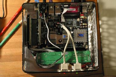

My own mini-ITX server acts as our xDSL gateway (PPPoE client), runs apache2 (web), smtpd (incoming email), spam filtering, imap/pop3 (for email clients), cupsd (print server), NFS/Samba fileservers, vpn/ssh (for remote access), manages our backyard kitty-cam, records/reencodes scheduled CBC radio shows off the web, acts as our complete SPI firewall (with custom enhancements), holds/serves my entire online photo archives, and half a dozen other minor services that I've forgotten about. Needless to say it uses (Debian) Linux for the task, which enables it to just work fine on low-power hardware. The motherboard is a VIA EPIA-CL6000E, chosen because it is totally fanless/silent and has *two* onboard 10/100 ethernet ports, plus a plethora of other built-ins including USB2, VGA, PS2 KB/Mouse, sound, parallel port, and a gazillion serial ports. I've equipped it with 512MB of SDRAM, which is plenty. It could handle a full GB, but then it would consume more power for no good reason. Fanless is *very* nice, so I paired it with a snap-on PSU designed for it (also fanless), which is fed from a +12V power brick (no fan there, either). One big (for the day) notebook drive on the inside, and voila -- a nice 24/7 micro-server. It has been rebooted maybe 5 times in the past 3-4(?) years since installation: basically only when I needed to rearrange the power cords, or wanted to try a newer Linux kernel on it. It has already outlived one UPS, and watched silently as other systems came and went. It has one now-open PCI slot, that used to house a third ethernet port for a DMZ for an old wireless AP we once had. Is SATA interface for 3.5" and 2.5" the same The interface/connectors are 100% identical -- no issues there. The machine will be running Linux (Clarkconnect firewall-distro), Xmail mail-server with ClamAV anti-virus scanning, Apache, Perl, php and MySQL for a content management system under Apache. It will be running basically headless, but connected to a KVM switch. Since it would act as a firewall, I would need two network cards, but I guess I can use a USB-dongle for the internet side. That's not a heavy load by any stretch, so go for whatever system you can get that is fanless (silent!), assuming you are pairing it with notebook drives. And look for a motherboard that has dual-onboard ethernet, which will save you a couple of watts of power. Cheers

I would probably go with a VIA EPIA SN10000EG (1GHz fanless) mini-ITX board today. It has both PATA(IDE) and SATA interfaces, dual onboard LAN, an a PCIe slot for expansion. Edit: Here's another link for it, with price and good photos. Cheers

The motherboard manual for my VIA board cautioned that proper airflow is a requirement for fanless.
So I have the board in a vertical mount, with lots of case holes above/below the board to allow a chimney effect to circulate fresh air across the heat sinks.
The hard drive is, of course, mounted at the bottom of the case, below all of the heat-generating components. A modern notebook drive only gives off 1-2W of heat, so it will self-cool so long as nothing else interferes.
