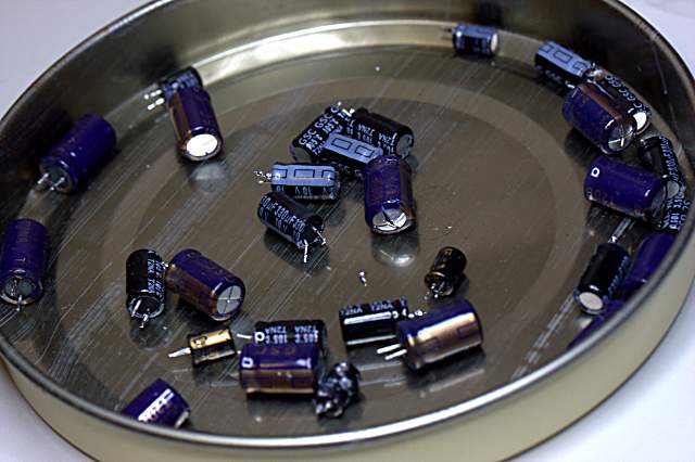

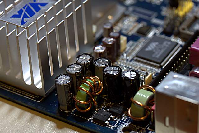

Okay, I had a look into the cookie-tin just now.
Yup, that particular capacitor is bulging quite a bit on top, as are about four similar ones of the same brand elsewhere in there.
I wonder how much longer I can ignore them? smile
Well, that question was answered this past week, just after I departed for a rock-climbing trip. frown
The system started crashing with various random errors, and SWMBO did her best to keep rebooting it in attempts to try and maintain internet/email access in my absence.
Now that I'm back, the hard disk has been moved to another machine to restore service -- I've actually just hooked it up via USB to a small notebook computer, along with a USB ethernet adapter to provide the second network port. Works fine!
Meanwhile, I now have to order some new caps from digikey to refurbish the mini-ITX board.
#322430 - 20/05/2009 03:34 Re: The Hackintosh [Re: mlord]
Digikey delivered today, and I've now replaced *all* of the electrolytic capacitors with new, high-grade / high-temperature ones.
Seems to be working again, for now.
Description: Dead caps.
Description: New caps.
#325605 - 30/08/2009 14:01 Re: The Hackintosh [Re: mlord]
Still working fine. Another thing we noticed is that the USB2 ports can once again power external notebook drives, something that hadn't been working for a couple of years.
Gee, I wonder why that was.. wink
