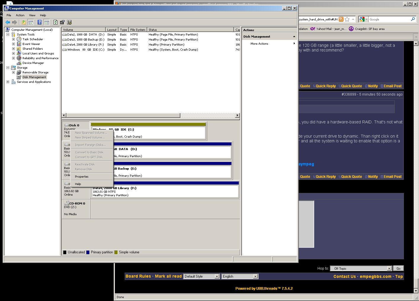

Can you explain that mirror trick in more detail?
Of course! IIRC Vista should be able to create mirrors via software, that is directly from the disk manager and w/o needing a dedicated hardware raid controller. If I am wrong, you will simply not find some of the menu items I am listing below.
I am basing the simple procedure below on Windows 7, but Vista should be pretty much the same in terms of menu structure.
0. Connect the new drive to your PC. Possibly placing it in its final location and using its final SATA port and cable. So you won't have to remove it later. It'll just stay there "for good". Boot your PC.
1. Start->Right-click on "my computer"->Manage
2. Storage->Disk Management.
3. Activate/import (whatever needed) your new disk, and upgrade it to Dynamic
4. Upgrade your old disk to Dynamic if it is still basic (right-click where it says basic)
5. Right-click to your old disk, selec "Create Mirror" . If Vista has this feature locked for license reasons (As I was saying, I can't remember which of Vista flavours, other than the Server - aka Windows Server 2008 R1 - is capable of doing mirrors and which is not) you will simpli not find the option there and this whole thing is not possible.
If you find the "create mirror" option, just click on it and select the new disk when prompted.
6. Let it build the mirror. It may take from 10 minutes to hrs, depending on the size of your disks, more precisely on the amd of data in the old disk. In your case, I'd expect 20 mins.
7. When done, you have a mirror system in place. Reboot your machine, just to be sure all is ok.
8. Shut down, remove old disk from your case, boot again. You will be prompted whether you want to boot from the mirror (C: duplex) disk as the old one is gone. Say yes. You system will boot, and if all is ok it will be blazing fast due to the SSD.
8. Logon, back to the Disk Manager. You will find your old disk there, marked as missing. Right-click on it, select to break mirror, accept all disclaimers, and then "remove" it logically (right click, remove).
9. Done.
Should anything go wrong, you can always plug your old disk in and boot from there, so it is fairly safe.
I've done this zillions of times in Windows Server of all flavors in the last 10 years, since Windows Server 2000 times, and I never had an issue. And, you've got 9 points up here just because I am trying to giude you step by step. What you're doing is really a piece of cake process, quite obvious and streight-forward.
I actually keep a mirror in my home server as well, so my HDD upgrades simply involve adding a couple of steps to create a new, larger mirror. Very convenient and simple.
I hope this helps. If not, let me know and I'll try better smile

#336880 - 08/09/2010 21:28 Re: Replace system hard drive without nuke and repave? [Re: Taym]
That is a lot of really good information. Thank you very much.
I know for certain that my computer does indeed support mirroring, since when the guy built it for me (he was chief engineer at the radio station where I worked) he set it up as a RAID system. The RAID failed and, not being a fan of RAID I changed over to a setup of individual hard drives. Since that time my hard drive storage has increased from 680 GB to 6.7 TB, nearly a ten-fold increase. And of course, every bit and byte stored in my computer is crucially important. Yeah, right. smile
I still have to shop for the SSD, and am not having much luck finding the Intel or Sandforce models you recommend. Any recommendations as to where to look? Edit: That's because Intel doesn't make a 128GB SSD. They have 80GB and 160GB. If their 80GB is smaller than my 80GB mechanical drive, I can't do the mirror, so I guess I'm looking at the 160GB.
I did have one thought of a minor problem: I am replacing a 3.5" drive with a 2.5" form factor, so of course the mounting hardware isn't going to work. Are there 2.5"<-->3.5" mounting adapter kits out there? There must be.
This really does look to be a straightforward process, unless I run into problems because my BIOS is unhappy with the SSD instead of a mechanical drive, or Microsoft is unhappy because my copy of Windows is registered to a certain hard drive. Hopefully if either of these problems arises it will be relatively easily solvable.

#336882 - 08/09/2010 22:13 Re: Replace system hard drive without nuke and repave? [Re: tanstaafl.]
There's a possibility that it does so via hardware controller built into your mb, in which case the procedure I suggested is going to be useless because you are going to create a mirror via the BIOS+Intel (typically) utility that comes with the raid controller.
However, the concept is unchanged: add new drive, create mirror, then break it, then remove old drive.

If you want to check in advance, just go to disk manager and upgrade your current drive to dynamic. Than right click on it and if you see a grayed "Add Mirror" option, you can create a mirror and all the system is waiting to enable that option is a second hard drive with enough empty space.

Here's what I see... (right-click to view image, zoom to read it.

Bummer, it only let's you create spanned and striped volumes, not mirror ones. What a silly thing to disable the feature.
You'll have to create the mirror via "hardware" (Bios + Intel utility).
Or you may hack a system file with an hex editor to enable the mirroring (I should have the info needed somewhere). At the next update that system file may (and will eventually) be replaced by a new version uncapable of mirroring, but by then you'll be on the SSD. I don't know whether I'd recommend something like that. I did it once in XP and irt worked, but stil...
