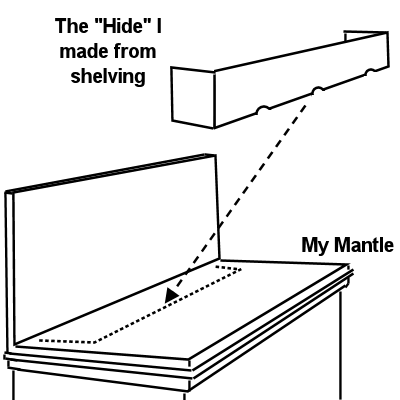

2. Custom backboard!
This one was a fun project. I moved into a brand-new house recently. The house includes a large mantlepiece painted gleaming white in the center of the living room. The top of the mantlepiece was VERY deep. It's about 6 feet wide by about three feet deep. Plenty of space for a big screen TV and a bunch of AV gear stacked up on either side of it. And if all the gear is at the front edge of the mantle, then there is about 1.5 feet of space behind it. Plenty of space for the rat's nest to run wild and free (and easy to maintain). But it was ugly. So here's what I did.
I bought some gleaming white already-pre-made shelving from the local home supply store. The longest one I could get was about the width of the mantlepiece. Also bought a smaller one to cut up for "ears" on the back of it. Screwed it together with some L-brackets on the inner-facing sides and it made a perfect "hide" for the cables. Notch a few "mouse holes" in strategic places on its bottom edge (cords from the AV gear tuck into the mouse holes), and bingo, no more cable mess. All hidden behind the gleaming white "hide" doohickey I made.
Hard to put into words, here's a thousand of them:
