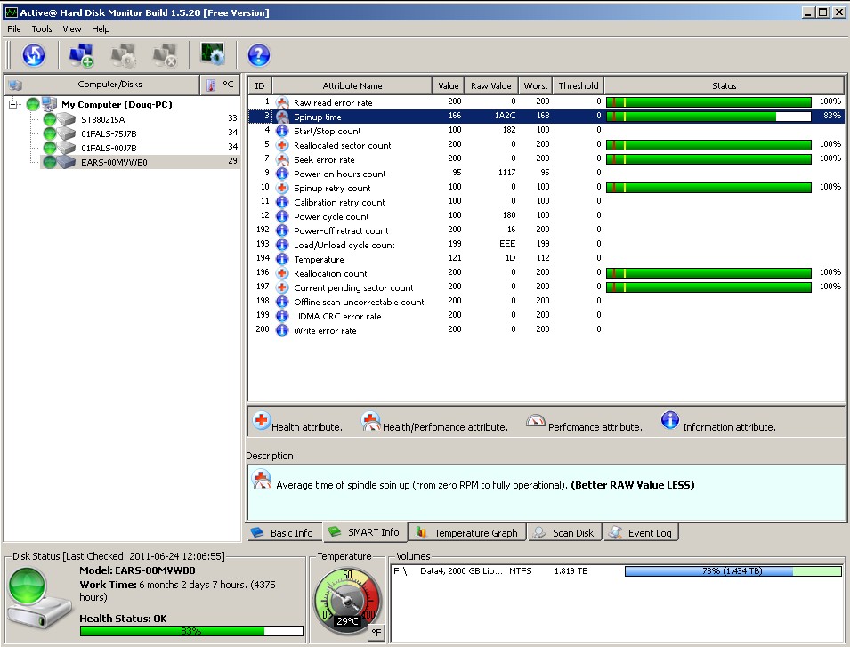

The SMART data for that drive show no obvious problems, so I think the drive may be OK physically. I am concerned about corruption in the file management table (or whatever it is called) on the drive.
