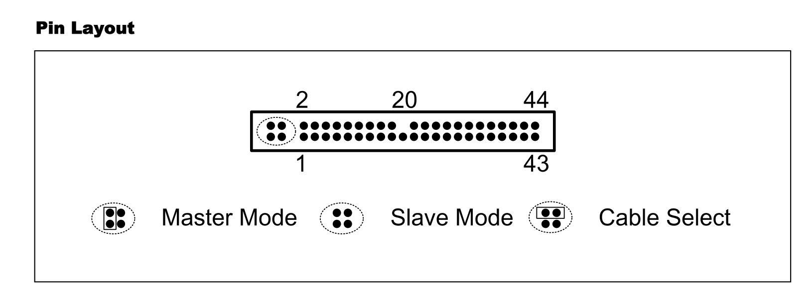

#348700 - 01/11/2011 20:55 Re: Error "Bad pump response" occured during stage 0x25 [Re: bauble]
Originally Posted By: bauble
It is (the only drive in the system).
hdb: TS64GSSD25-M, ATA DISK drive
Your SSD is set to Slave, instead of Master. You need a jumper to set it to master. Here is the info from the manual for your SSD.
*edit* the reason I can tell this is that hdb is the typical Linux designation for a hard drive on the primary IDE bus, as the slave device. hda is the normal primary master device. I don't remember offhand how hardcoded the player software is, but my belief is that the player software (and root fs) needs to be on hda.
Edited by drakino (01/11/2011 20:59)
#348707 - 02/11/2011 00:53 Re: Error "Bad pump response" occured during stage 0x25 [Re: drakino]
bauble
Registered: 23/06/2003
Posts: 57
I'd really thought you were on to something, as I'd at one point had the SSD jumpered. I tried again, jumpered once as master and once as slave (thinking that I wanted to cover all/both bases)...no luck. :-(
sigh. I think I'm back to thinking that my SSD is bad.

It looks like we are back to the SSD not being detected. Is it plugged into the same spot on the cable it was last time?
Mark, any idea if this is a potential bad IDE header issue where the drive works only as a slave device and not master? Though what I find odd is that things worked when both hard drives were in the system. Maybe a bad cable instead (the crimping issue?)
#348763 - 02/11/2011 22:41 Re: Error "Bad pump response" occured during stage 0x25 [Re: bauble]
bauble
Posts: 57
For no good reason, I slaved the Transcend SSD to the smaller (2GB) one (the 2GB was able to load by itself without any issues).

Can it be a problem with the player or the cable if I'm able to use both to successfully set up two conventional drives (one master and one slave)?
#348766 - 02/11/2011 23:18 Re: Error "Bad pump response" occured during stage 0x25 [Re: drakino]
bauble
Posts: 57
Just realized I hadn't answered your question; apologies.
Yes, the SSD is on the same spot on the cable; and jumpered as master (well, it was when you posted that question).
#348771 - 03/11/2011 05:03 Re: Error "Bad pump response" occured during stage 0x25 [Re: bauble]
The different permutations helps, though I'm personally out of suggestions. Hopefully Mark can help decode some of the messages in the last boot log you posted, with the SSD as slave and the smaller 2G drive as master. My understanding of it shows that the empeg didn't properly detect the slave (hdb) drive.
#348781 - 03/11/2011 11:44 Re: Error "Bad pump response" occured during stage 0x25 [Re: drakino]
Posts: 14537
I have no idea what you're doing wrong.
But the hardware appears to be working, though I dunno why the SSD doesn't show up as master when no other drive is connected.

Last time I got this error it was because the stupid cable was not seated completely into the motherboard. D'OH! Now I know why they hot-glued these cables into place at the factory.
