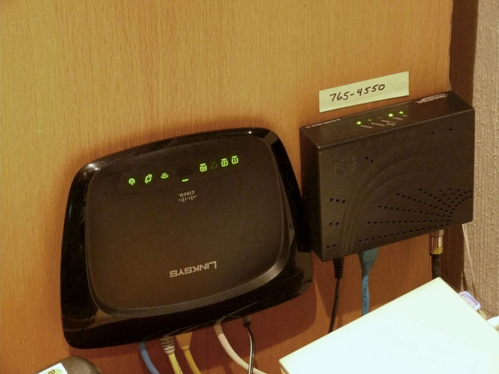

I have a WRT54G2 router (the flat, sort of saucer-shaped one, see picture) that doesn't seem to be working right. I think. Maybe.
This morning I could not connect to the internet, so I went to a DOS prompt (OK, for you purists, a pseudo-DOS prompt, there is no DOS in Vista smile ) and found that I can quite reliably ping Google.com. I started my PingLogger program and for the past seven hours have not missed a single ping. My VOIP telephone (by OOMA, highly recommended) works just fine. My printer (which is also run through the router) works. But neither my computer nor SWMBO's Macintosh can connect. Nor can the downstairs neighbor's MacPro notebook, nor her iPod Touch. The latter two use the wireless aspect of the WRT54G2, while my computer and SWMBO's Mac are wired directly.
The topography is simple: Cable Modem --> WRT54G2 --> various devices. Everything seems in order, except that none of the computers will connect to the internet.
So... I bypassed the router and connected my computer directly to the cable modem (that's how I am writing this) and now nothing works internet-wise (printer, wireless, VOIP phone) except my computer. So the router seems to be the problem. I logged into the router (192.168.1.1) and all the settings seem to be correct, but what I know about routers and wireless connectivity is essentially... nothing.
If the router is broken when trying to use a browser (and we have tried four different browsers: Firefox, Internet Explorer, Safari, and Chrome, plus whatever an iPod Touch does to connect), but my DOS prompt shows connectivity, what does that mean?
I am way over my head here, and would welcome helpful suggestions.

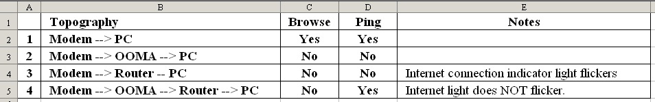

Something new has been added to the mix. The "normal" configuration is Modem-->OOMA-->Router-->PC. If I take the OOMA out of the circuit, so it is Modem-->Router-->PC, then the internet connectivity light on the router begins flashing rapidly, and nothing works. This is a new behavior, and may be suggestive of a hardware problem in the router.
Here is a chart showing the various configurations and their results.

Connected directly to the modem, any CPU (or at least, my CPU and SWMBO's iMac) will work. Throw the router into the mix, and things go badly.
I am going to do the factory reset now, which may cut me off from you guys for days until I can get my settings reinstalled. If I survive that and it still doesn't work right, I'll reinstall the firmware. After that, if still no joy, then I'll buy a new modem.
Look at the little chart in the previous post (right click --> view image to see it in a more readable state) to see what happens with the various configurations.
