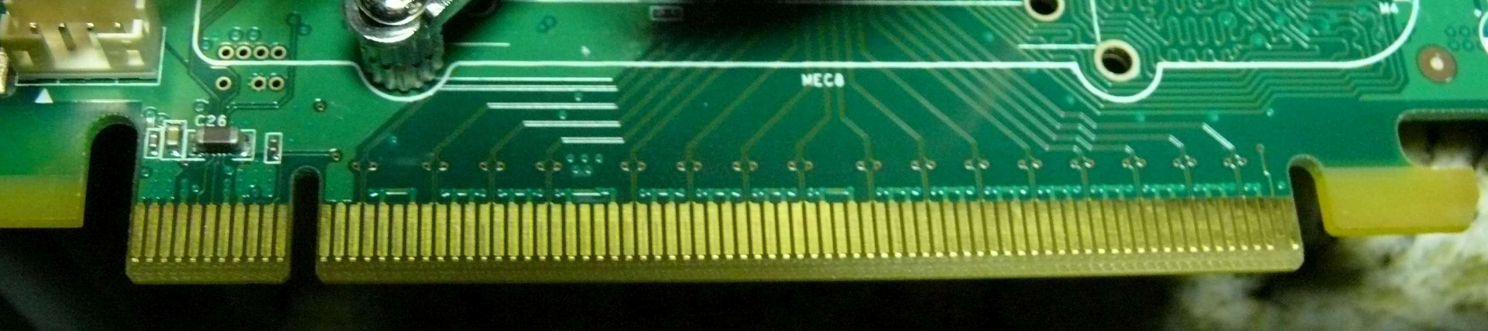

Are you sure it's PCI for the video card? It's much more likely to be AGP. You may be right. How can I tell? Here is a photo of a spare video card I bought on ebay last year when I thought my regular one might be going bad. It turned out that the power cable was loose where it plugged into the monitor.  Can you tell by looking at it whether it is AGP, PCI, or even PCIe? tanstaafl.

Looks like oldest AGP 1 - 3.3v
Newer cards are keyed differently. Also note the hook on the right side of the image (rear of the card) - older PCI graphics cards don't have that. It mates with a locking clip on AGP ports.
#350658 - 08/03/2012 01:42
Re: Video Card Advice needed
[Re: hybrid8]
To clarify what Bruno said, It's definitely AGP. The hook on the end is a dead give away before even looking at the "keyed" slots.
Also if you have a look in a machine of that vintage you'll see a bunch of slots all the same which will be PCI and then the slot closest to the CPU will be set back a bit further from the edge of the board. Conventional colours would be PCI=white, AGP=brown or something else too.
Yes that's 3.3V only card (1 key on the left). But remember this is a replacement card bought as a spare and is not necessarily indicative of the card in the machine now.
Got a motherboard model?
Re-reading, you haven't even tried it yet. Plug it in like Mark says and let the card talk to the monitor. Yes the driver will only show what it thinks the monitor is capable of so is probably basing that off your old model. It will read the capabilities. Does the card have DVI? Use it if you can. Worst case it won't run at its native resolution and will be slightly blurry (pet hate of mine is people that do that...)

Hmmm.... I'm not so sure on the AGP now. Comparing against this, AGP had those alternately offset wider pads like this  And the slot is not in the same position. Actually the replacement card is looking more like PCIe. Doug, perhaps you bought a PCIe replacement card thinking it was PCI?
#350662 - 08/03/2012 03:08
[Re: Shonky]
It's a PCIe 16x video card.  And Shonky, you found a rather interesting AGP card to show. Thats a very specific model that has an ADC port on it. That extra connector in front of the AGP connector was used to pull extra power, to allow a 17 inch CRT attach to the computer with just one cable (no power cable needed).

Doug's card is definitely not AGP. All AGP cards I've come across have that staggered pinout seen in Shonky's picture.
#350674 - 08/03/2012 12:20
[Re: andym]
Posts: 14530
Doug's card is definitely not AGP. All AGP cards I've come across have that staggered pinout seen in Shonky's picture. Yeah. Doug, that spare card is a PCI-Express (PCIe) card. Not PCI. Not AGP. EDIT: heck, from your photo one can even see the 16 PCIe "lanes" (pairs of wires/traces). Count'em! 16 lanes == a "x16" card. (note: there will be 16 more pairs on the flip side of the card, for the other direction). Cheers

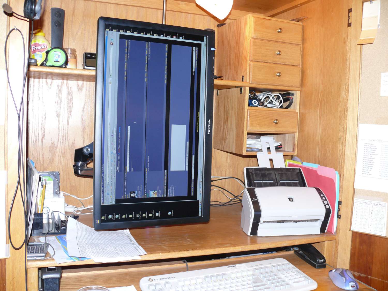

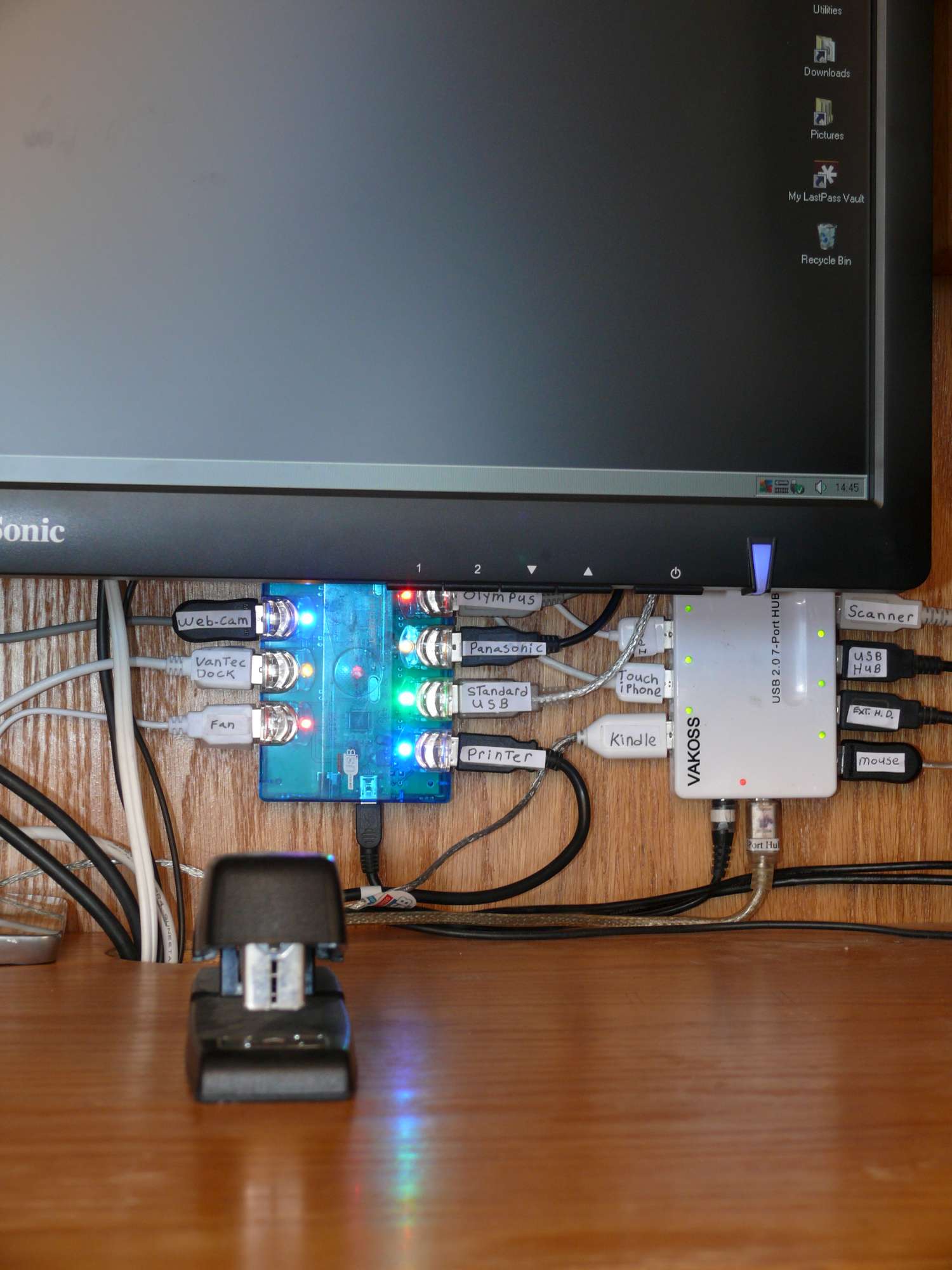

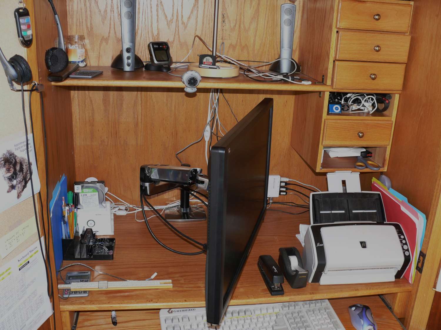

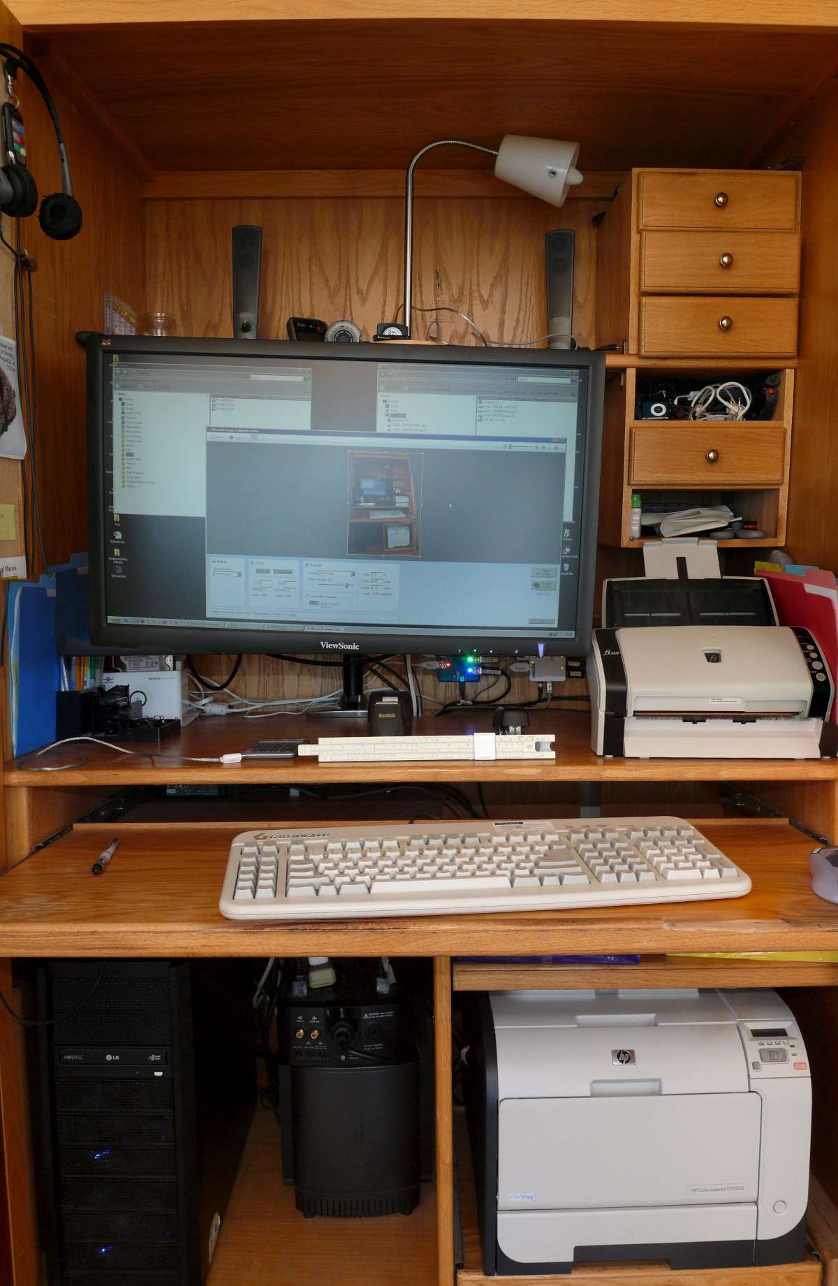

#350996 - 19/03/2012 19:59
Last month I treated myself to a new 27" HD flat-screen monitor,
In the unlikely event that anybody cares, here is what my computer setup looks like now. It is very compact, as there is not a lot of room in the house. To the right of the monitor is my 60 ipm* scanner, below the keyboard is a 20 ppm color laser printer, left of the printer is the subwoofer for my sound system and on top of that is an APC UPS with eleven A/C things plugged into it! (Used to be 16, but I moved the cable modem, the router, the OOMA phone, the OOMA base station, and the local phone over to SWMBO's UPS.) Behind the monitor on the left is a Vantec external HD dock with my 2-TB backup drive in it. There's another external drive you can't see behind the scanner. The monitor will swing back flat against the wall to give unimpeded desktop space when needed. If you look carefully you'll see the pickup for the wireless mouse stuck to the wall next to the scanner. There are shelves below the keyboard tray for storing four reams of printer paper. I deliberately did not show the top of the computer hutch which is piled a foot and a half high with really ugly-looking odds and ends: CD/DVD containers, cables, some headphones, tape, dust-off cans, spare video card, my Rosetta Stone software box, etc. I apologize for the ugly hand-lettered labels on the USB hubs but the cables are all different lengths and when I try to run them through my laser printer I keep getting "Unexpected Paper Size" errors. When I get that sorted out I'll print the cables up real pretty with an Arial Black font.  In addition to the 14 USB ports populated on the hubs, there are two more (headphones and Flash Drive) coming out of the front of the tower. Yes, it is a pretty loaded system. The keyboard is PS2. The computer is nothing too special by today's standards, but it was pretty hot stuff when we built it in 2007 with dual-core 3gHz AMD processor, 4 GB RAM, 256MB video card, and [now] more than 6-TB of hard drive (including the two external backup drives). There is also a pair of 2-TB backup drives kept off-premises. All in all it is an ergonomically friendly and extremely space-efficient setup, and I am quite pleased with it. tanstaafl. * 30 ppm duplex = 60 Images Per Minute
Edited by tanstaafl. (19/03/2012 20:04) Edit Reason: One of the pictures didn't load.
