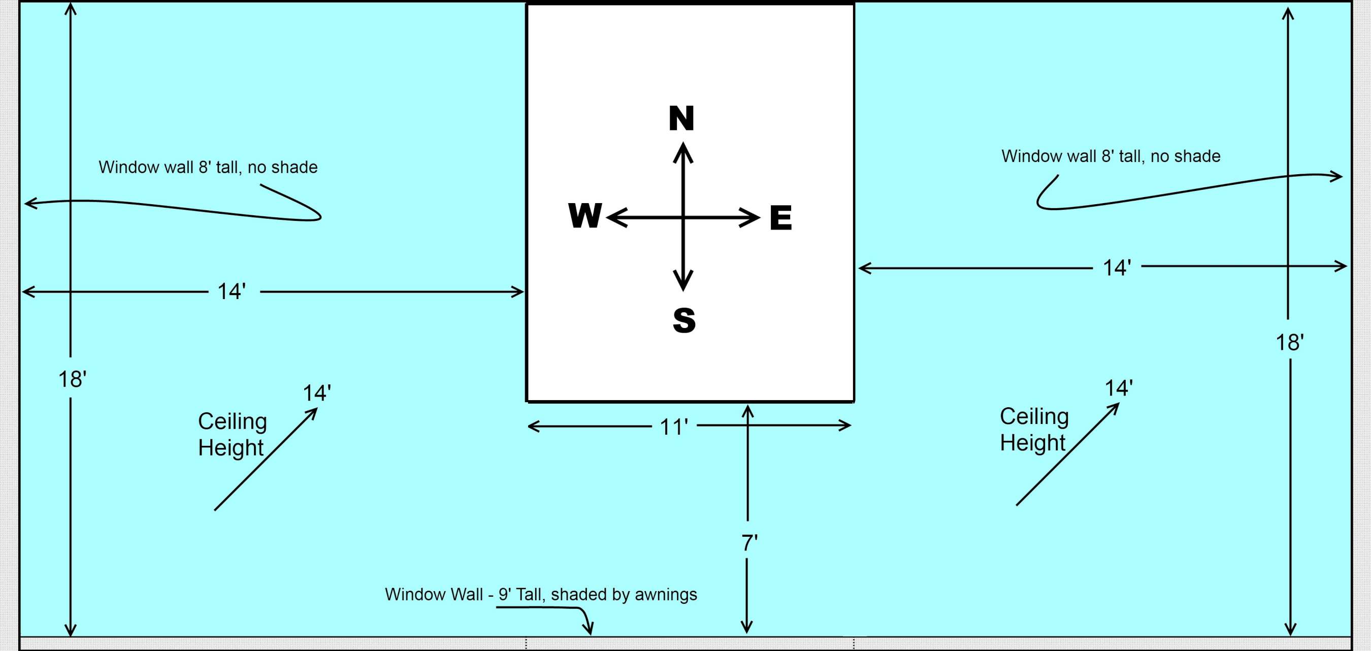

In a few weeks I'll be buying and installing my long-delayed air conditioner, and I am finding it not so easy to determine just what capacity I need. Too small and it runs all the time and costs a lot to operate. Too big and it doesn't run enough to dehumidify the air (although I don't think that would be a big problem here, this is high desert with low humidity.) The best source I have come across is this one where they take into account a lot of variables that the simple rule-of-thumb charts seem to ignore. Things like ceiling height, hallway widths, window area relative to wall area, wall construction, home location, SEER rating, etc. I am distrustful of the results, because the annual operating expenses seem unreasonably low. Attached is a rough layout of the area that I am trying to air condition. The calculator linked above said I would need 26,300 BTU/hour. Does this seem reasonable? There is only about six weeks a year that the A/C would operate, daytime temperatures seldom exceed 90 degrees (F), evening temperatures usually drop down into the high 60's. We would be cooling the house to about 75-80 degrees. All walls (interior and exterior) are 8" masonry, as is the ceiling, all uninsulated. I know some of you have a lot of experience with air conditioned homes. Does 26K BTU seem right? How many hours a day do you think it might need to operate? tanstaafl.

Looking at the plan a bit of a roof overhang on the W & E would make a huge difference to the amount of morning and evening sun, S would deal with the rest of the day. A bit of external insulation on the roof would help too.

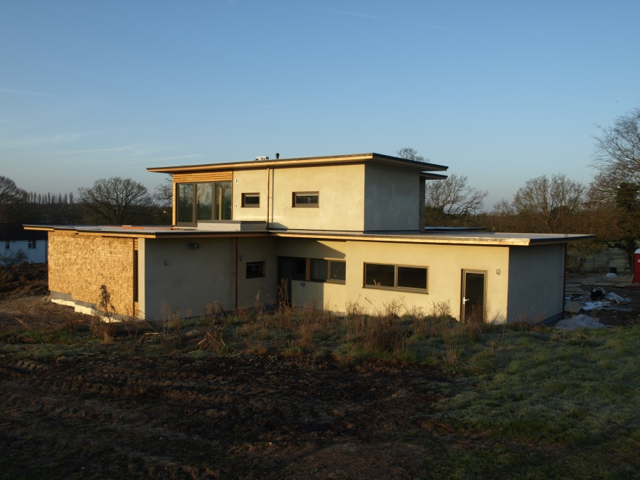

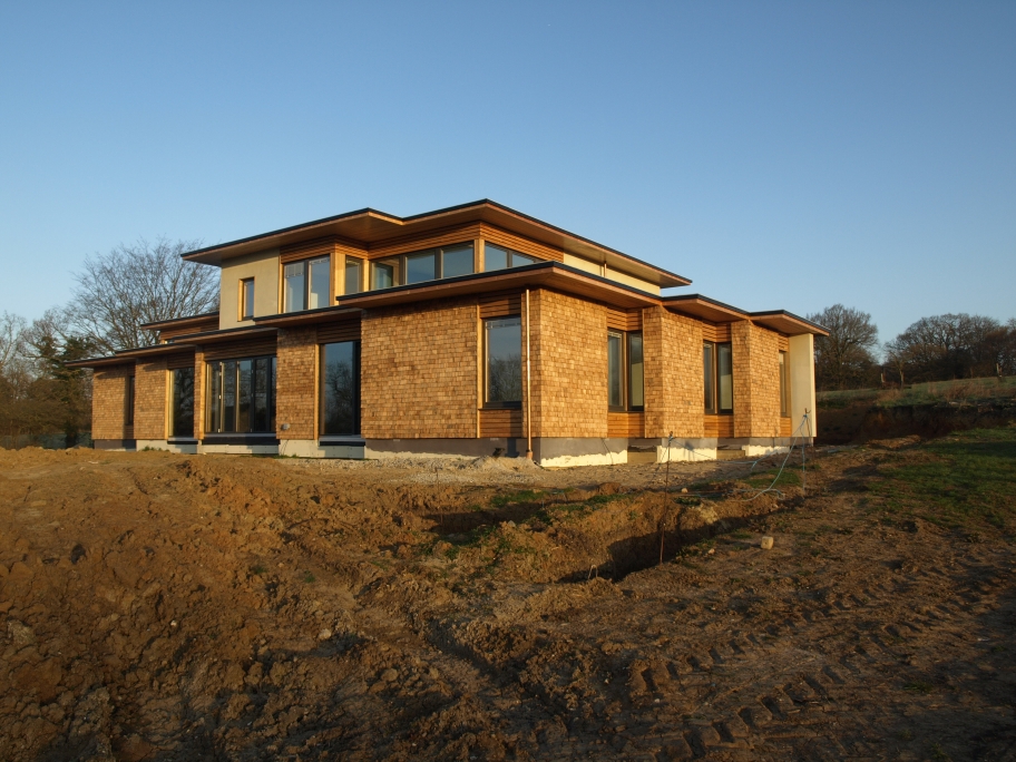

Even here in the UK our architect was worried about summer overheating (lot of glazing) so we have around 1 mtr overhang all the way around the house.

Looking at the plan a bit of a roof overhang on the W & E would make a huge difference to the amount of morning and evening sun, S would deal with the rest of the day. A bit of external insulation on the roof would help too. As a matter of act, there is about a 1-meter wide soffit above both the East and the West windows, but by the time the sun has climbed high enough that the soffits would offer shade, it has swung around enough that the awnings on the South windows have taken over the job of sun blockage. Insulating the roof is not easy. The ceilings are domed, and thus the roof (outside) is domed as well. It isn't just a matter of laying down sheets of styrofoam insulation, it has to be cut and shaped to fit the contours of the roof. I got an estimate, don't remember exactly how much it was, but the A/C was cheaper. tanstaafl.

My office is 1/2 of that size, but similar in that it's mostly glass. You're lucky 'cos in the summer months the sun will be north of you and away from that big south glass wall.
I had a 12K btu air con in my office and it wasn't nearly enough. I had to start it early in the morning to give it a chance to keep the office just mildly hot in the afternoon. This is with outside temps in the 90s.
So, you've got double the air con, and double the space and windows. Even with the solid north wall, you might consider the next larger size air con. And at least two of those heads.

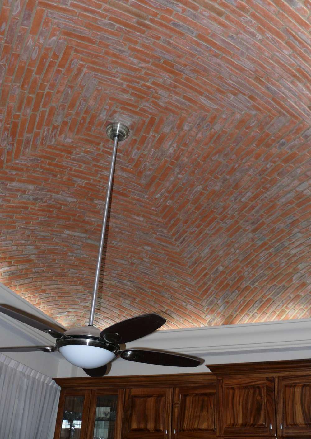

Can you get someone to foam the roof? Probably... but a cost/benefit analysis suggests that it might not be feasible. Yesterday, in the process of getting 220V power up to where the compressors* will sit, I learned a bit more about the construction of this house. Carlos (the engineer/contractor who built the house, and still owns the two bottom floors) went somewhat overboard in its construction, by local standards at least. The roof is about fourteen inches thick, made of bricks set edgewise on the inside, and outside covered with concrete painted a painfully bright white** to reflect heat. On a sunny day you really need sunglasses to be up there. The ceiling inside is 14 feet above the floor at the highest point of the dome. I would guess that not a lot of heat is getting through that roof, but I have no real data to back up that assertion. I do have data to estimate what my air conditioning costs will run me, however. Making the hopefully not unwarranted assumption that my A/C will run for four hours per day in April and May only, 36,000 BTU with a SEER of 10.3, at a cost of about 21 cents/kWh***, my annual operating cost should run about $180. Insulating the roof would not obviate the need for the A/C, because we have discovered to our dismay that SWMBO simply cannot tolerate high heat. If the temperature in the house is in excess of 85 degrees F (29C) she is literally incapacitated. Not just uncomfortable, but completely unable to function. If insulating the roof saved (arbitrarily) 40% on my A/C operating costs, it would take decades to recover the cost, and I don't know how well the foam would stand up under the intense sun. Probably they have that part figured out, though... So, for better or worse, the A/C contractor will be here later today to do the installation. A pair of 18,000 BTU mini-splits, heat-pump systems for cooling and heating, operating independently in each room. We will keep the inside temperature between 75-80 degrees to minimize usage, we're both comfortable at that temperature. About $1800 including installation. Let the adventure begin! tanstaafl. *Two 18,000 BTU (1.5 Ton) units, one for the bedroom, one for the kitchen/dining room. **When flying over Texas desert on the way down here one time, I was absolutely astonished to see whole subdivisions, hundreds (thousands?) of houses, all lined up in rows with black roofs. ***Electricity pricing here is amazingly complicated. Our electrical usage is low enough that most of it is at the "Basico" rate of about 6 cents per kWh, some of it at the "Intermedio" rate of about 10 cents. But on the months that the A/C runs, most of that additional usage will fall into the "Exceso" rate, of about 21 cents per kWh. If I ran the A/C all year long, I would fall into the dreaded "DAC" rate ("Domestico Alto Consunción") in which every single kWh I used would be billed at the Exceso rate of 21 cents per kWh. My neighbors across the street with a big house and swimming pool are paying eight times as much as I am per year for electricity, but are probably using only 50% more kWh. They're on the DAC rate, I'm not. I have made a fantastically complex spreadsheet that accommodates all the variables involved in projecting an electric bill: the three tiered rate structure, the DAC penalty, the cost effectiveness of solar panels with amortization times, sales tax, projected rate increases based on past performance, pesos vs dollars, number of meters, months per billing cycle, wattage of appliances, etc. Interestingly (to me, at least, probably not to you guys) our computers (my PC, SWMBO's iMac) are using exactly as much electricity as the rest of the house combined. After 10 months of operation, the computers have consumed 1167 kWh, the rest of the house is at 1166. The A/C will be split across the two meters so the "meter parity" will continue. db

It is indeed very cool. We looked at a timbrel vaulted roof for our new house, the engineer we spoke to had already completed this one and went on to do this one One of the reasons the architect was keen on the vaulted ceiling was how much weight it would carry, ours was designed to carry 6ft of soil above. We've ended up with a much more traditional (but still super insulated) construction, the roof will be planted over autumn.
