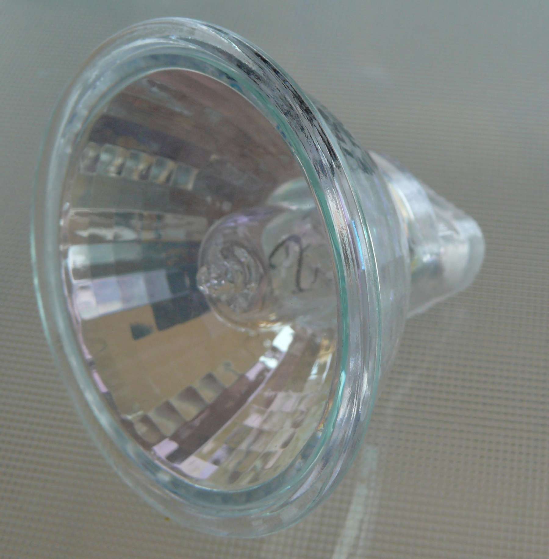

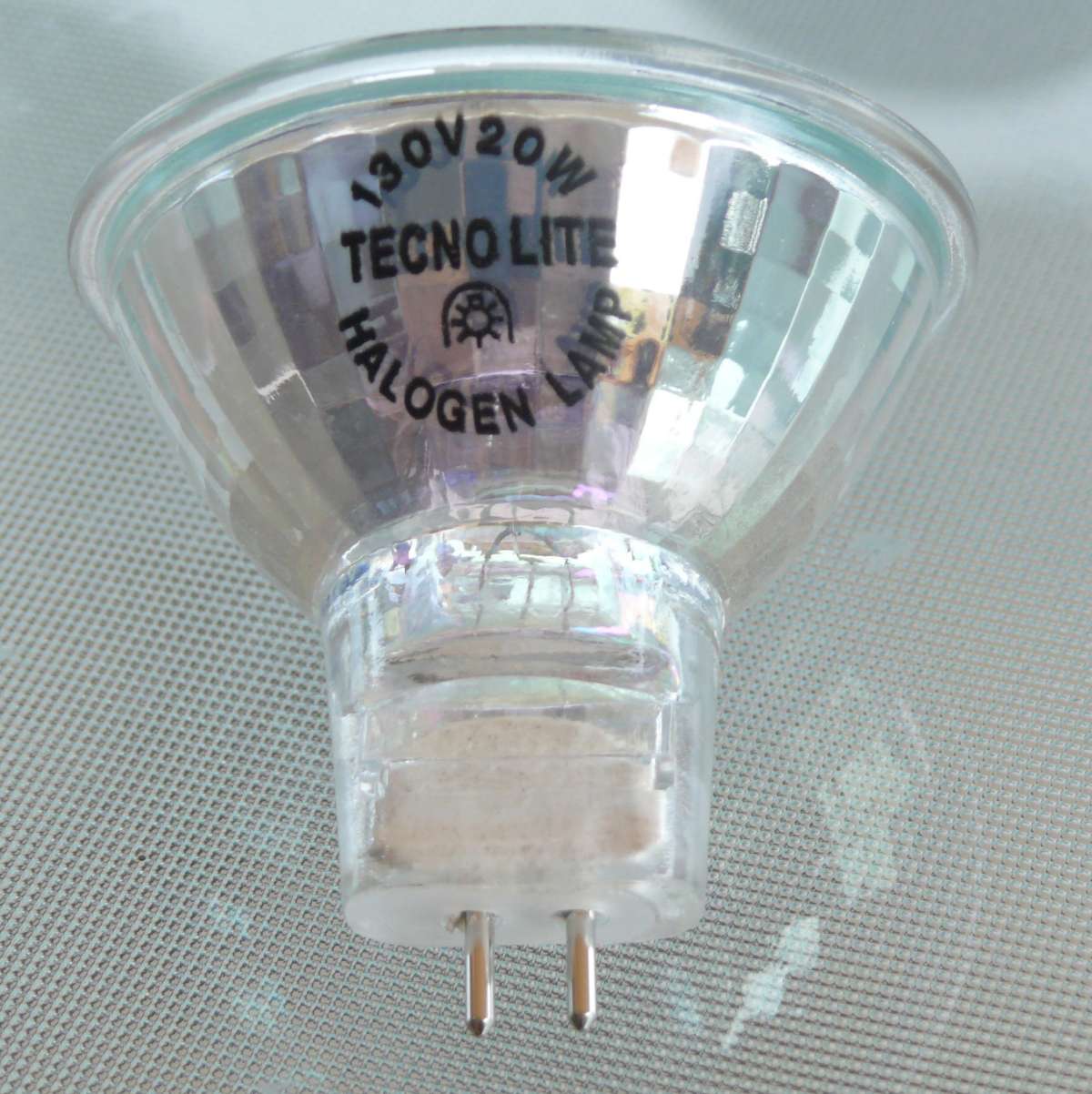

I have 23 light fixtures in my house with halogen bulbs similar to the one pictured below, except that most, if not all of them are 50 watt, not 20 watt. What would I do to change over to LED lights? Can I get LED bulbs to fit the existing fixtures, or do I have to tear up my ceilings and cabinets and install new fixtures? How expensive is this?

That looks like a MR16 lamp with GU5.3 socket/base, but Rob would probable know off hand. If that is correct, then Toshiba make something suitable http://www.toshiba.com/lighting/products/led-lamps/mr16-gu53.jsp although not quiet bright enough, they seem to max out at 35w equivalence.

That's a weird bulb, usually line voltage MR16 will have GU10 bases... you might have to swap out the sockets to use a line voltage led.

This would appear to be the manufacturer's page for that bulb, if that helps.

These are 12V, which is what I would expect in the UK with that GU5,3 connector. Exactly as Larry says, you would want to factor in changing the lampholders over to GU10. What I would sell here is the Lampholder at 1.25, and a Megaman Modo 4.5W GU10 (42W Equivalent, non-dimmable, available in 3000K and 4000K) at 8.00, that's all inc Tax. This is all in 230V though, but I would imagine you would be able to find something similar in 110V in Mexico, at the same price you're looking at roughly 190 Pesos.
What I would sell here is the Lampholder at 1.25, and a Megaman Modo 4.5W GU10 (42W Equivalent, non-dimmable, available in 3000K and 4000K) at 8.00, that's all inc Tax. This is all in 230V though, but I would imagine you would be able to find something similar in 110V in Mexico, at the same price you're looking at roughly 190 Pesos. I reckon you need at least 11w LED to come close to a 50w halogen, 14w would be more convincing. Our new house has these: http://www.orluna.com/products/mini_recessed.aspxand these: http://www.nationallighting.co.uk/LED_Lighting/LED_Fittings/LED_Downlights/LUCIDA/pid/988The 2nd ones are probably as close to a 50w halogen as I've seen from an LED but definitely not GU10. I know that Phillips, Toshiba and others do higher powered GU10s but the Phillips (which I've seen) has a little fan in it (v annoying). An alternative might be CFL GU10s, I haven't seen any in operation but might be worth a look: http://www.tlc-direct.co.uk/Products/GUC...CFc0mtAodfi4A9Q
