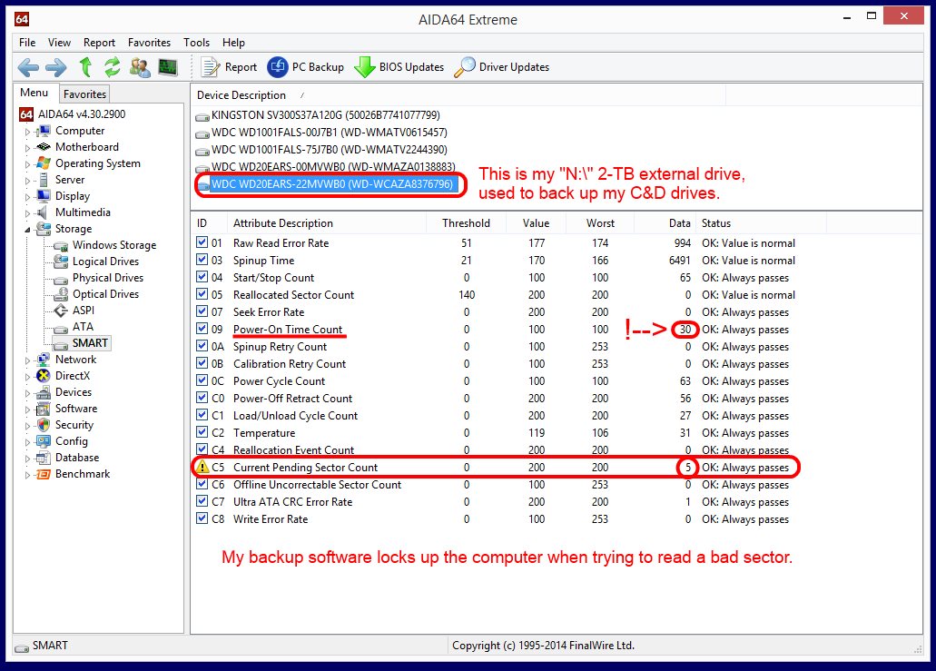

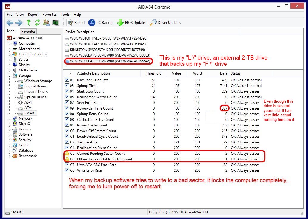

I have suffered two hard drive failures this week. Actually, I think they failed months, even years ago, but only now have the symptoms become severe enough to make them unusable.
The disks are both 2-TB Western Digital Caviar Green series, neither one with more than 100 hours of actual powered-up time. These are disks used in an external dock, used only for backup purposes. One of them is an off-premises disk, only used three or four times a year for less than half an hour at a time. The other is kept on-premises and used more frequently, but for even less time during each use.
Attached are screen shots of the SMART data that I am not smart enough to understand, other than that the little yellow triangles are not funny-looking happy faces. frown
The computer shop tells me there is nothing that can be done. I'm hoping that someone here (are you listening, Mark?) might know more than they do. Any hope for these drives, or are they expensive paper weights? These drives were both purchased on-line and sent to me here in Mexico. Quite possibly they were not gently treated during shipment.

#361843 - 30/05/2014 01:56 Re: Two hard drive failures in one week. [Re: tanstaafl.]
Posts: 14530
The stats are showing ATA CRC errors, which is not a normal thing to have. Check the cabling, or get new SATA cables, as short in length as possible.
The little yellow triangle things indicate to me that the drive is starting to have issues. WD drives do behave strangely compared with other drives here, so it's never clear exactly what the heck is going on with those attributes. Other than that those are never good to see non-zero values on.
The nice thing, is that I *think* both drives are probably still readable in full. The "pending" bad sector counts seem to mean that the drive has temporarily marked some locations as "bad", but intends to try correcting that the next time those locations are overwritten with fresh data.
After which they may (or not) go bad again.
Were they my drives, I'd probably relegate them to non-critical uses, or scrap them. But given your situation, you may want to try to hang onto them until they show worse symptoms.

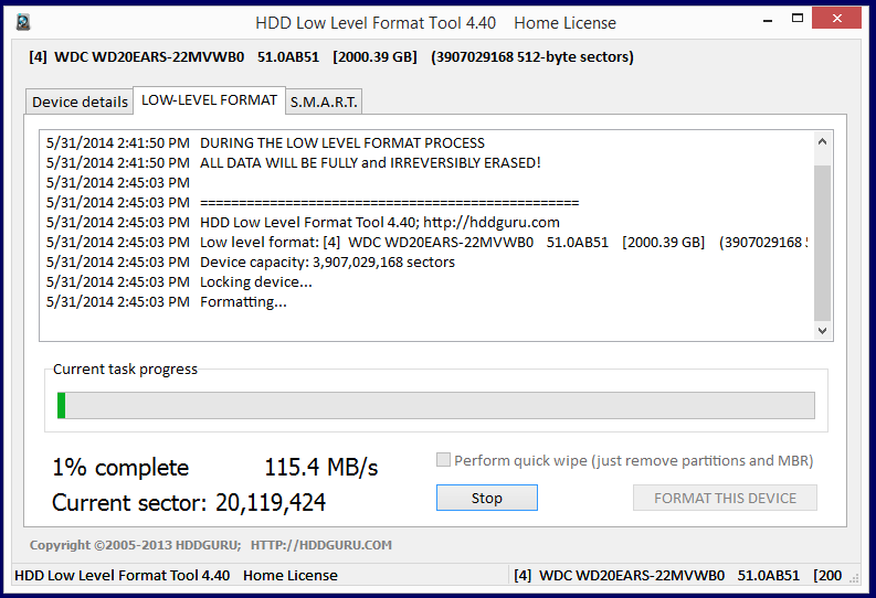

So, a Google search for "Hard Drive low level format tool Windows 8.1" took me here and I downloaded the tool and even paid for the upgrade which more than doubled the speed. It seems to be working just fine, and reasonably quickly. I figure the whole job should be done in, hmmm, let's see... 1,800,000 megabytes @ 115 MB/sec = 15,652 seconds, or about four hours and twenty minutes.
All in all, much easier (for me, anyway, probably not for you!) than trying to set up a Linux boot media and mis-typing the command line parameters. smile
In about four hours, I'll let you know how things turned out.

That tool very likely does NOT really do a real low-level format. It certainly does NOT issue the SECURITY ERASE command, because if it did, the tool would not have any control over how quickly or slowly it runs.
Can you elaborate on that a bit? I don't fully understand what Security Erase does. I thought the low level format wrote zeroes to every bit on the hard drive.
So, are you saying that this tool will not remap the bad sectors? I thought the disk firmware did that.
The upgrade just removes the throttling put on to the free version of the tool (max speed of the free version is 50MB/sec) as an incentive to purchase the reasonably priced ($3.30) upgrade.
That tool, apparently, just attempts to write zeros to every mapped sector on the drive. Which works, most of the time. So it sits there, in a loop, writing 512 zero bytes at a time, until the entire drive is accounted for. The Linux equivalent (free) is simply "cat /dev/zero > /dev/sda". Except this program deliberately slows itself down unless you pay the ransom.
What a SECURITY ERASE command does, is tell the drive to format itself, which will always be better / more reliable than some hokey program writing zeros. Since the drive itself is doing the format, it runs at full drive media speed. As fast as the mechanism can do it. And with full knowledge of defect management.

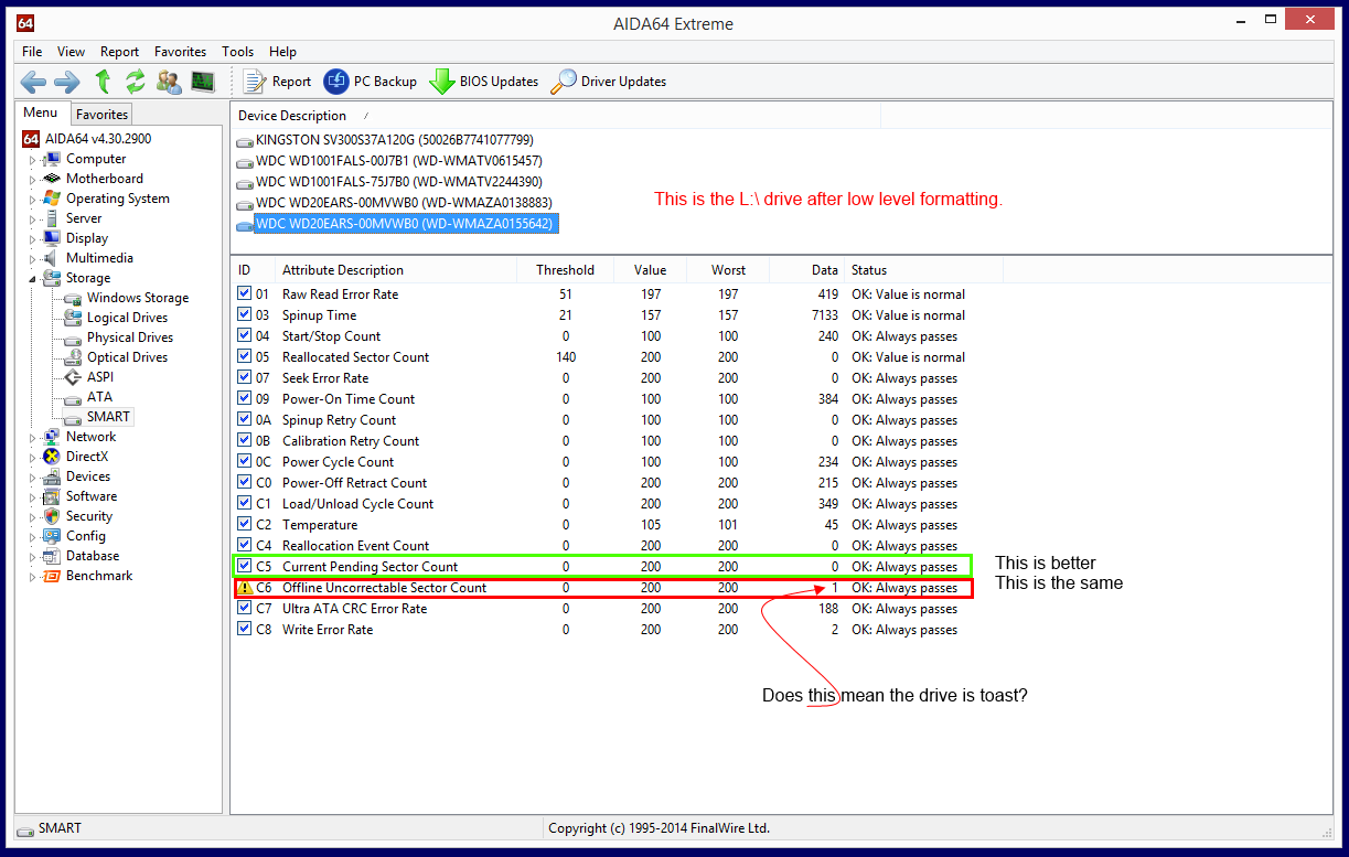

So now, four hours to go. Again.
Here is the SMART data after the reformat.
The "Current Pending Sector Count" went from 2 to 0 (that's good, isn't it?) while the "Offline Uncorrectable Sector Count" remained at 1.
Isn't the "Offline Pending Sector Count" just the number of sectors found to be bad and remapped so they won't be used? Or do I misunderstand that completely.
At the moment I am running a Western Digital extended diagnostic test. The "Quick" test indicated that the drive "Passed". I think I'll cancel the WD diagnostic and give it a real test by seeing if it will successfully back up my "F:\" drive. My backup software isn't very robust, and crashes hard when it finds an unreadable sector, so it may be a more effective test than WD's. smile

#361887 - 01/06/2014 18:16 Re: Two hard drive failures in one week. [Re: tanstaafl.]
Posts: 14530
Dunno what "pending" means.. I think WD invented that word in this context. smile
The "reallocated" count tells how many bad sectors have been remapped to good spares.

#361889 - 01/06/2014 20:27 Re: Two hard drive failures in one week. [Re: mlord]
From what I've been able to determine, the "Current Pending Sector Count" is the number of bad sectors that for some reason cannot be remapped as bad, whether it's a glitch in the firmware of the hard drive, or there are no more reserve sectors into which to map them, or some other reason. When the CPSC is non-zero, it is bad news because the hard drive cannot reallocate any more bad sectors.
Of course, I may have completely misunderstood all that...
Right now I am backing up 1.72 TB (out of 1.81 total, 95% of capacity) onto the formerly defunct L:\ drive. The backup runs alphabetically by author (that's how the files are sorted) and before it always crashed at "Feehan, Christine...". It is currently at "Hugo, Victor..." and chugging along nicely.
Fingers crossed...
