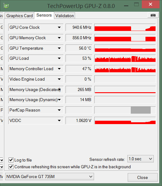

Sometimes when playing a 3D game with the Nvidia GPU, there are periods when the game's frame rate drops suddenly to a slideshow. This happens randomly, but on average it occurs approximately once every 30-60 minutes of gameplay. When the problem occurs, the frame rate is terrible for about 30-90 seconds or so (the length of the problem is also random), then miraculously the frame rate goes back to normal. While the problem is occurring the game is essentially unplayable due to the massive amount of control input lag making mouse selections nearly impossible.
This isn't because I've reached a moment in the game where there are extra graphics or draw distance or effects on the screen. To the contrary, the problem occurs completely independently of what I'm doing in the game or how complex the graphics are in the game at the time. For instance, right now I'm playing Legend Of Grimrock 2, and the problem can occur equally whether I'm in an outdoor area with a far draw distance, or staring at a blank wall in a narrow dungeon corridor. In fact, the problem can occur even when I have the game paused. Also, I have noticed that the problem occurs in different games too, as long as they use the Nvidia GPU. Though the degree to which the game is affected by the problem varies. Games which do not use the GPU as heavily (for example, I also noticed it occur during the flat-shaded cartoonish game "The Marvelous Miss Take") are not as problematic when the issue occurs, though, the issue does still occur in those kinds of games, because I can see it happening with the Techpowerup GPU-Z utility.
If I run the Techpowerup GPU-Z utility, I can clearly and unambiguously see that this is caused when there is a PerfCap of reason "16" ("Util") occurring. I have attached a screen shot of this happening in GPU-Z. You can see it very clearly, as if someone has taken a giant bite out of the GPU performance graph, accompanied by a gray bar in the PerfCap Reason graph.
I've done some googling, and from everything I've read, this PerfCap reason occurs because the Nvidia drivers think that the GPU is not being utilized, and therefore is reducing the voltage to the GPU in an attempt to save battery life on the laptop (despite the fact that I'm plugged into AC power at the time). Indeed, when I look at the detailed log file from GPU-Z, there is a brief moment right before the perfcap occurs which says that the GPU and Memory Controller load values are, for just one second, zeroes. This might be the precipitating factor, but I can't imagine why they would be those values, because I'm actively running the game and playing it when the problem occurs.
Also, I don't see the game freeze or pause when the issue occurs, just, a sudden drop in frame rate while I'm playing the game, accompanied by a corresponding input control lag (making the game nearly unplayable). If the game *had* frozen for a moment, I could understand why it would hit PerfCap 16. In fact, if I load up a save game, or perform a quicksave in the game, then, yes, it does briefly (for a very short time during the game save or game load) do a perfcap 16 as expected because the 3D graphics aren't being used during the time that it's loading or saving the game. The problem I'm talking about isn't a save/load perfcap, it's an actual perfcap happening while I'm playing and the GPU is getting actively used. Also note that if I pause the game (for example, if I press the ESC key in Grimrock 2), then the GPU is still getting used to draw the rendered game world (even though it's not moving/changing) and the GPU utilization is still in the 50 percent range. I can let the system sit there on the pause screen as well, and the problem still occurs randomly, as seen in the GPU-Z graph.
Here are some things I have tried, in order to diagnose it:
- Attempted to find out if it was excessive temperature or GPU load causing the issue. It's not. As you can see in the screen shot, the GPU and memory controller load is only in the 50 percent range, and the GPU temperature is in the tepid Mid-50c range. I can run graphics demo programs which bring the memory controller load and GPU load up to the 99-100% range and heat the GPU up to about 66c, but no perfcap occurs during those tests. So it's not excessive temp or GPU load.

Looking at GPU-Z, I can see that the Nvidia GPU is still the chip that's being used when the problem occurs... it's just that the voltage to the chip has been throttled to increase the battery life of the laptop.
