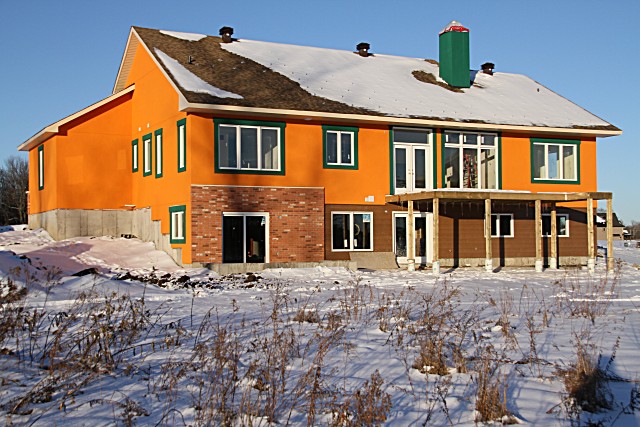

But much of our time lately is devoted to a new hardware project, with projected completion (Phase I) later in January.
Phase II (a 10KW photovoltaic array), and Phase III (deck, and attached greenhouse) are slated for late spring 2015.
Description: New house (the rear/South side).
Edited by mlord (30/12/2014 21:46)

Well, more as it happens. But for now, the roof clips for mounting the solar array are slightly visible in the above photo. And the in-attic wiring was completed early on, to avoid having them tread through the attic insulation that was added afterwards.
The rear side of the house (pictured) faces exactly due South, for maximum solar gain. Having it about 5 degrees to the East might have been slightly better --> optimizing the panels' effectiveness earlier in the day, before they overheat and lose some efficiency later in the day. But due south is pretty good, and the best we could realistically achieve on the given site.
The partial wall of bricks (left) is for the inside of the future greenhouse.
And the chimney for the wood stove is green, because.. well, everyone knows a pumpkin stem is green, right? smile
Edited by mlord (31/12/2014 00:40)

So what happens when the snow piles on the solar array rather than the shingles? <ducks>
#363185 - 31/12/2014 00:51 Re: Merry Christmas to All! [Re: Phoenix42]
Posts: 14545
smile Hopefully it blows off again (wind direction is favourable for this), or melts. Or covers them for a few days during the lowest sunlight times of the year.
A steeper roof pitch would have been nice -- better solar gain as well as better for keeping the snow off. But rather more expensive too, so we passed on that.

... A steeper roof pitch would have been nice -- better solar gain as well as better for keeping the snow off. But rather more expensive too, so we passed on that...
Must the solar array exactly match the slope of the roof and the pre-installed mounting clips?
Can the solar rack have a steeper angle than the roof, with the 'clip to solar array' attachments being progressively taller as you move up slope?
A roof of 30 to 35 degrees is ideal for solar panels. I can't tell exactly from your photo, but it doesn't look that far off.
Also, do you already know which panels and inverter you will use? I leaned towards SunPower, but eventually settled for Silevo Triex T-series, because they seemed to be a better value for money. SunPower is more efficient even, but also a 10% more expensive - besides, if you've got roof space enough, efficiency isn't all that important). With regards to the inverter, I really wanted a system that was able to address the panels individually, because we have a lot of trees over here and one dirty panel (with leaves or otherwise) means the rest of the panels on the same string will also loose about half of their capacity.
I leaned towards the Enphase system, which uses one micro-inverter underneath every panel, and directly produces AC power. The reason for this was it decentralizes the setup eases the setup even. The downside, and reason I didn't went for this system in the end, was the monitoring system uses Powerline. That in itself isn't that bad, but the Enphase Powerline monitor didn't have a serial out, and I really wanted that because I wanted to connect it to my home automation setup. This was not possible with Enphase, alas. (I guess I could have used a Kwh counter with S0 output also now I think about it...) So in the end I went with a SolarEdge system. This system uses a bit of both: Power Optimizer boxes underneath each panel which hold all the intelligence, and one "dumb" centralized inverter, with all the connections I needed.
#363188 - 31/12/2014 11:46 Re: Merry Christmas to All! [Re: K447]
Posts: 14545
That would create a massive snow-holding wedge, and the snow/ice would just peel the panels from the roof, in this climate anyway. smile
They could angle the individual panels for better gain, but our solar subcontractor has had a very bad experience doing this in the past. Something to do with high winds picking the panel and roof up off the house. Our location is particularly windy at a bad angle, so.. not in this case.
Well, for ideal solar gain, our panels would want to be 45 degrees, matching our latitude (45N). Except we get less light in the winter, as well as some snow cover, and more light in the summer, so a different angle might be better. Tough call though.
