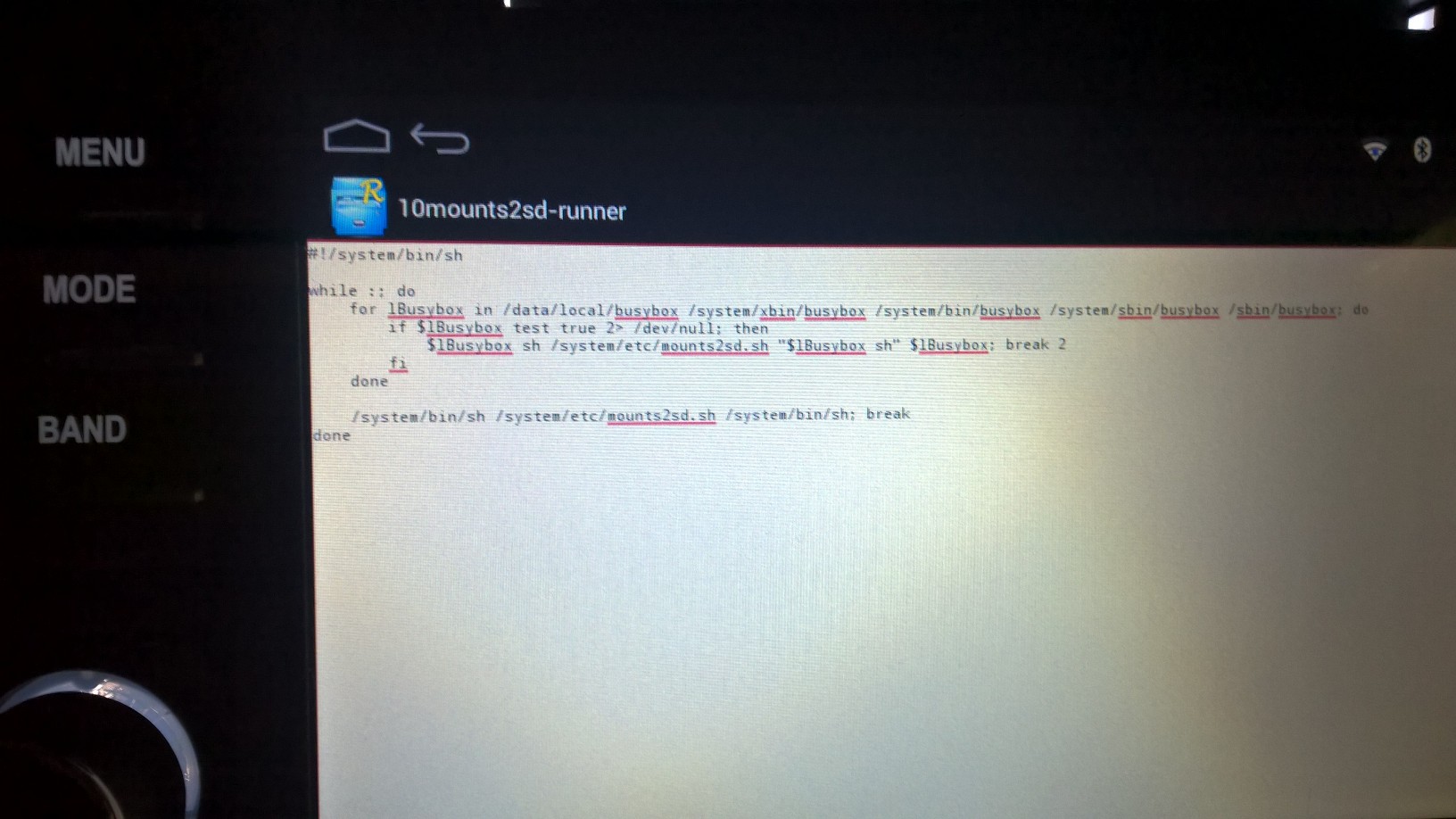

#364367 - 05/07/2015 15:31 Re: Android infotainment system storage question [Re: Taym]
I think so.
Mount2sd placed in /etc/init.d the script 10mounts2sd-runner.
I am attaching a screenshot of what it does. In int, I saw a reference to a mount2sd.sh located in /system/etc , which I also guess was created by the app. I am attaching that too.
mounts2sd.sh (226 downloads)
#364369 - 06/07/2015 01:38 Re: Android infotainment system storage question [Re: Taym]
Posts: 14530
Gag. What the heck is that script doing in 1575 lines of code???
This is really a two liner:
#!/system/bin/sh
mount /dev/mmcblk1p2 /data
Maybe save the original script and replace it with the above two lines?
EDIT: Wait: not sure about the exact path.
The script uses _mount for everything, whereas the standard (Linux) command is mount (no underscore). Get it wrong, and your phone might not boot.
Researching..

One more question, guys.
Let's suppose I start the unit with a different microSD, not containing the ext3 partition (mmcblk1p2) referred to in the boot script.
This is the case when I have to plug the microSD in containing just the firmware upgrade. In fact that's just how the unit works: start the system upgrade process and it will look for the firmware img files in that microSD slot.
Now, what happens? The boot script is run and... ? Mount will fail and I am back to the original /data? Or, will the system hang?
#364384 - 07/07/2015 20:06 Re: Android infotainment system storage question [Re: Taym]
Posts: 14530
It will have trouble, possibly not booting at all.
That's partially why the original script is so huge.. it probably tries to handle all kinds of weird stuff like that.
#364385 - 07/07/2015 21:39 Re: Android infotainment system storage question [Re: Taym]
Ok, I see. Thank you Mark. I'll have to think twice on how I do this, as firmware upgrade is quite frequent with this unit.
I am now considering using the internal 5GB storage space - currently FAT - originally used as user storage space mmcblk0p9 (even if it says extsd1, it is in fact internal).
I'd have to convert/reformat it in ext3, and then use the script you helped me with. In theory it seems a good plan. 5GB of app space is still pretty good! smile
