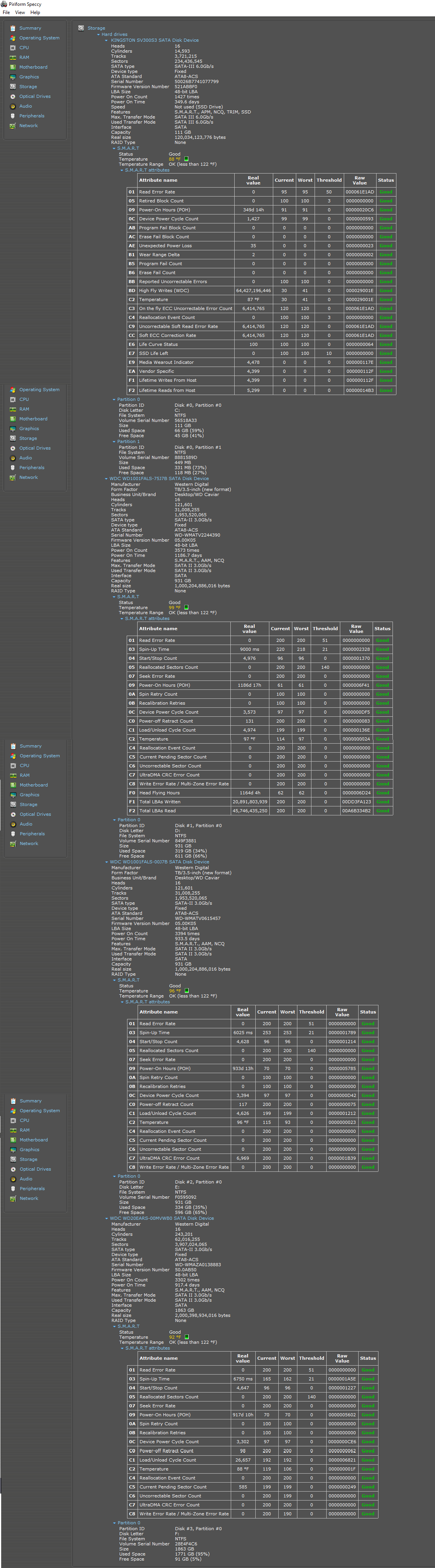

BTW, if anyone is looking for a simple SMART data reader, Speccy is a nice application. It gives you a good amount of information on your computer.
#367186 - 07/07/2016 18:20 Re: Drobo HDDs: high failure rate? [Re: Dignan]
I found it, downloaded it, installed it, and I really like the simple interface. I'm not S.M.A.R.T. enough smile to make much sense of what Mark posted, but this output (see attached screenshot) even I can understand. A little bit, anyway.
Very nice, Thank you.
tanstaafl
speccy 01.png (212 downloads)
