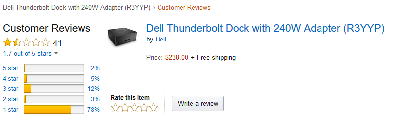

Also, I looked at that exact model, but it gets absolutely horrendous reviews due to very bad driver support from Dell. I wasn't even able to bring it up on Dell's own website so I'm not sure they make it anymore. It's sold through a 3rd party on Amazon. That's one of the things that made me start wondering if there's some sort of unreported problem with USB-C, that the only two docks I've seen with multiple monitor support have been removed from the market...

Surely you jest! This is the worst review percentage I have ever encountered on Amazon.com. Am I missing something here?

I have a XPS 13. Yes it supports Thunderbolt 3 over the USB-C connection. You can get a number of double display adapters (4K @ 60Hz x 2) but that's all they support. No power, USB, Ethernet etc. There are a number of adapters that do USB-C only and thus only have HDMI or VGA outputs. The main issue for me is the lack of 60Hz output. I've lived with 30Hz though and for desktop/programming it's really not that bad.
The Dell TB15 dock linked on Amazon was released early this year but had massive driver, stability etc problems. Even with driver, BIOS etc updates it was still dodgy. That's where all those bad Amazon reviews came from.
I noticed I got a Thunderbolt firmware update just recently for my XPS 13 so maybe that's fixed it finally? They had stopped selling the TB15 completely for a while. Perhaps it's "fixed" and back on the market? On paper it will do what Matt is looking for (and me too).

#367316 - 02/08/2016 22:26 Re: USB-C and two or three monitors [Re: Dignan]
Looks like the TB15 is still not officially for sale from Dell. Their recall/stop ship is still in place.
Unfortunate as it seems to be the only device capable of what I want.

#367340 - 04/08/2016 23:48 Re: USB-C and two or three monitors [Re: Dignan]
Looks like I was right about the price. I finally stumbled across this device. It's not even slated for release until the end of next month, but it does most of what I was looking for. It's a Thunderbolt 3 dock.
The only thing that I don't like is that it says it only does a "trickle charge" for the connected laptop instead of a real charging solution. Sounds more like it maintains battery levels instead of trying to top them off.
*edit*
That Dell dock you initially linked to is also a Thunderbolt dock, but I don't know which if the scenarios you laid out either of these docks are using. But it sounds like driver support might sink these kinds of things.
Edited by Dignan (04/08/2016 23:49)
#367342 - 05/08/2016 01:29 Re: USB-C and two or three monitors [Re: Dignan]
Only 15W. XPS 13 has a 45W adapter so if the laptop is off it will take triple the time to charge roughly and if on will hardly charge it at all. If you were fully loading it up, it might not even be able to sustain it. Should be pretty easy to get an idea with a Kill-A-Watt type meter on the input side to the existing supply.
The Dell TB15 has a much higher power output and is a full replacement for a power supply. Unfortunately the rest of it seems badly supported by drivers/firmware/buggy hardware.

#367348 - 05/08/2016 15:55 Re: USB-C and two or three monitors [Re: mlord]
Having now read a lot more on these topics, I like the idea of the ThunderBolt-3 ports which use a USB-C type connector.
Agreed. It's nice to see it include the power capacity to charge laptops. Thunderbolt 1-2 had a 10W limit, and was meant to power devices downstream. The jump to TB3 over USB-C makes it possible for one cable docking solutions.
(2) The hub could instead use PCIe protocols, again with or without a DisplayPort overlay. This increases total cable bandwidth up to 40gb/sec for all attached devices. In order to provide one or more USB ports, a PCIe USB host adapter chip (XHCI for USB3) would be needed inside the "hub". Other PCIe host adapters could also be incorporated, giving additional "native" SATA/eSATA for example using an AHCI chip. And/or even some physical desktop machine style PCIe or PCI slots.
This is the option I like the most even with the additional cost. The Razer core linked earlier has my interest as a way to drive a VR headset from a notebook due to the PCIe slot. And the prior TB1 monitor from Apple worked in this way. The display has it's own USB 2 root hub and controller, along with a firewire controller, and a gigabit NIC. Off the monitor USB bus is a sound device for the built in mic and speakers, along with a webcam. It's been a nice solution for my laptops since 2011 and I'm glad to see it hitting more widespread adoption with TB3. (Was hit with a bit of nostalgia seeing the old LightPeak thread back then.)
That TB15 would be perfect if they could just get it to work!
Back when TB1 was rolling out on the Apple side and a few PCs, there was a few months of various firmware and driver updates to stabilize the new tech. TB3 is likely going through similar as more vendors come online and also sorting out the details of running over a new connector. Out of the box, an early adopter friend of mine had to get through a number of updates for the Razer Core before it worked. Things will likely stabilize for most vendors and devices by the end of the year or sooner.

Dell WD15 is USB-C and does PD
Dell TB15 could do PD but was plagued with issues.
Dell TB16 (seems to be TB15 replacement) looks like it's available
So I think there's a few around, but only slowly coming through.
#368488 - 21/03/2017 03:03 Re: USB-C and two or three monitors [Re: Shonky]
Dell TB16 ... looks like it's available
It has a VGA port confused
Dell TB16
Edited by K447 (21/03/2017 03:04)
