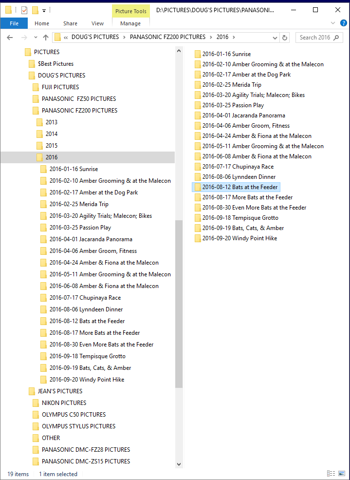

I realize that this is more a shortcoming on my part than on Apple's (you know, "It ain't what I'm used to, so it can't be any good") but I despise Apple's basic philosophy whether it be applications or operating system. That philosophy as I see it when I attempt to support my wife's iMac is to protect the user from all of the really ugly computer stuff... stuff like directory trees, filenames and extensions, and actual file locations. For example, I organize my photos MY way, not Bill Gates' way. Now before we start a war between the Apple people and the Windows people, let me say that the Apple hardware I've experienced has been the best I've ever seen, absolutey top quality. And I'm sure that Apple software is wonderful for people whose mindset is different from mine. It's just that I've invested too much time in learning the Windows environment to want to switch now.
#367651 - 02/10/2016 20:58 Re: One major (?) Windows 10 problem [Re: tanstaafl.]
Posts: 811
Do I see two folders with the exact same name?
Amber & Fiona ...

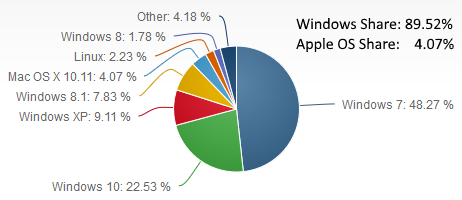

How much time do you spend supporting Macs vs. PCs? From my purely anecdotal experience, there's a dramatic difference.
I'll bet there is. Of course, that time difference might be influenced by there being twenty-two times more Windows computers out there than there are Apple OS-X machines.
Be that as it may, I have found Windows 10 to be absolutely rock solid and far less trouble to me than SWMBO's iMac although her problems would no doubt be trivial to somebody who knows as much about OS-X as I know about Windows, which really isn't very much!
Anyway, let's NOT get into a Windows vs Macintosh war. I tell people that my wife and I require separate computers because of our religious differences: She is Macintosh, I am Windows. smile

#367661 - 03/10/2016 17:14 Re: One major (?) Windows 10 problem [Re: K447]
Where is that 'share' chart sourced from?
Actually, I just made up the numbers.
Naaah, not really. Here. smile
#367662 - 03/10/2016 21:12 Re: One major (?) Windows 10 problem [Re: tanstaafl.]

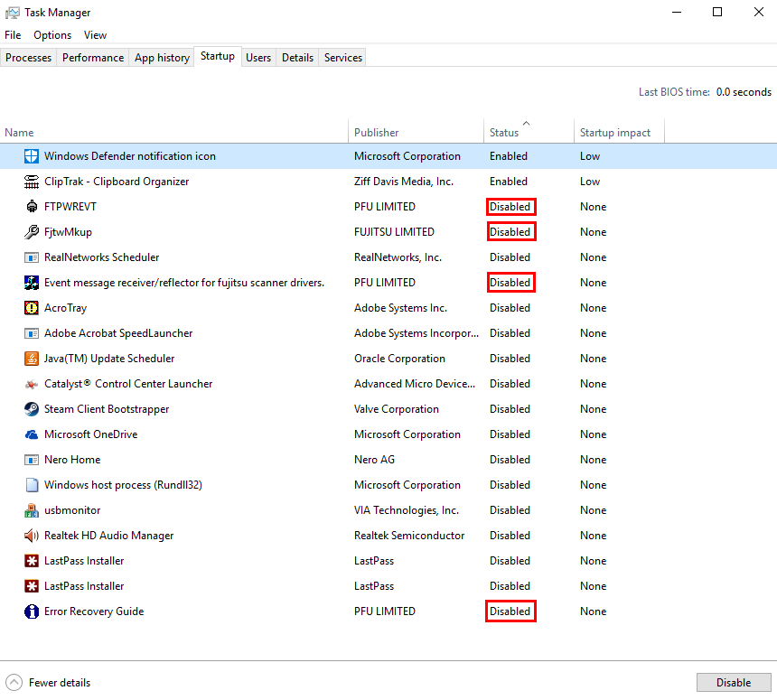

My Startup menu is pretty simple, although I will have to re-enable the four disabled items outline in red, they are necessary for my Fujitsu scanner to work, I think. (It's the only application I have found that won't work.) For now I'll leave them alone.
I am going to unplug that router cable and turn off the printer power, then try rebooting again, as those are the only two conditions I can think of that were different from the repair shop. I don't really expect this to work. See you in five to ten minutes, I guess...
