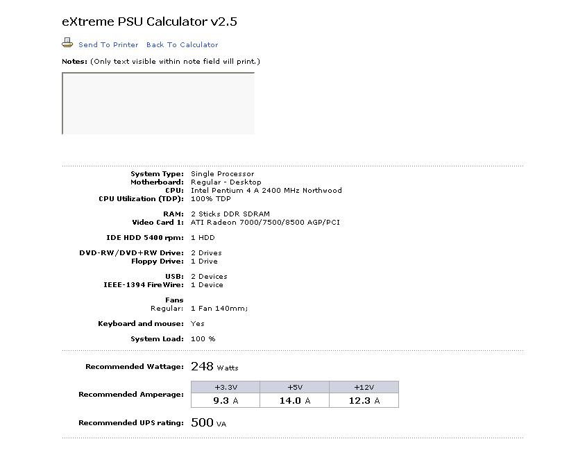

#305585 - 30/12/2007 20:32 Re: Power supplies - always draw that much power? [Re: AndrewT]
Neutrino
Registered: 23/01/2002
Posts: 506
Loc: The Great Pacific NorthWest
Mark,
Here's what extreme came up with for the first system you posted.
Edited by Neutrino (30/12/2007 20:34)
No matter where you might be, there you are.
#305586 - 30/12/2007 21:10 Re: Power supplies - always draw that much power? [Re: Neutrino]
Posts: 14514
 Originally Posted By: Neutrino
Mark,
{ 248 Watts }
That's the second system I posted for (not the first).
The Enermax PSU in use there is rated at 375W, I think.
Edited by mlord (30/12/2007 21:11)
