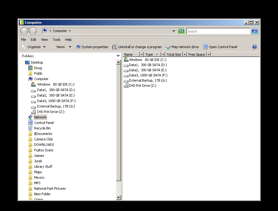

One of my backup drives is an external 1TB SATA drive. I leave it powered down except when I am backing up. In order for the computer to see the drive, I have to power up the drive and then reboot the computer. Is there a way to mount the drive (Windows Vista) without rebooting?

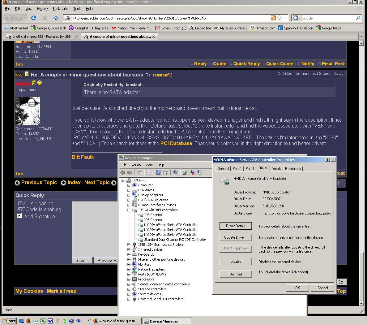

Just because it's attached directly to the motherboard doesn't mean that it doesn't exist. If you don't know who the SATA adapter vendor is, open up your device manager and find it. It might say in the description. If not, open up its properties and go to the "Details" tab. Select "Device Instance Id" and find the values associated with "VEN" and "DEV". (For instance, the Device Instance Id for the ATA controller in this computer is "PCI\VEN_8086&DEV_24CA&SUBSYS_052D1014&REV_01\3&61AAA01&0&F9". The values I'm interested in are "8086" and "24CA".) Then search for them at the PCI Database. That should point you in the right direction to find better drivers.
#326327 - 24/09/2009 14:31
Re: A couple of minor questions about backups
[Re: wfaulk]
open up your device manager and find it. Is this it? (see attached...) All I need to do is click on the "Update Driver" tab? I am guessing that the "NVIDIA/nForce Serial ATA Controller" line shows up three times because there are (at the moment) three SATA discs running? (I don't have the external one powered up at the moment.) What happens if the update fails and none of the discs (including the "Windows" disc (it's an 80 GB IDE disc) with the OS and associated files) work? It'll be pretty hard to click on that "Roll Back Driver" tab then... am I putting all my eggs into what appears to my uneducated eye to be a pretty scary basket? We all know that Windows (especially Vista) is a rock-solid, completely stable and robust operating system, and the chances of anything ever going wrong are laughably minute. But still, being no doubt unjustifiably paranoid, I can't help but wonder. Am I on the right track here? tanstaafl.
#326328 - 24/09/2009 14:52
There are three most likely because there are three controllers on the motherboard. You still need to download an updated driver first, and from perusing nVidia's download site, there's not enough information on that screen for me to immediately figure out what you need to download. However, assuming that it's an nForce 9-, 7-, or 6-series, here are links to the Vista32 drivers and the Vista64 drivers. If anything goes wrong, you should still be able to boot into safe mode. Vista does still have a safe mode, doesn't it?

Am I on the right track here? Here's how to find the vendor ID, etc.
#326330 - 24/09/2009 15:07
I am guessing that the "NVIDIA/nForce Serial ATA Controller" line shows up three times because there are (at the moment) three SATA discs running? (I don't have the external one powered up at the moment.) Its 3 controllers. Each one has two SATA connections if I remember correctly. They all show up even if nothing is connected to them.

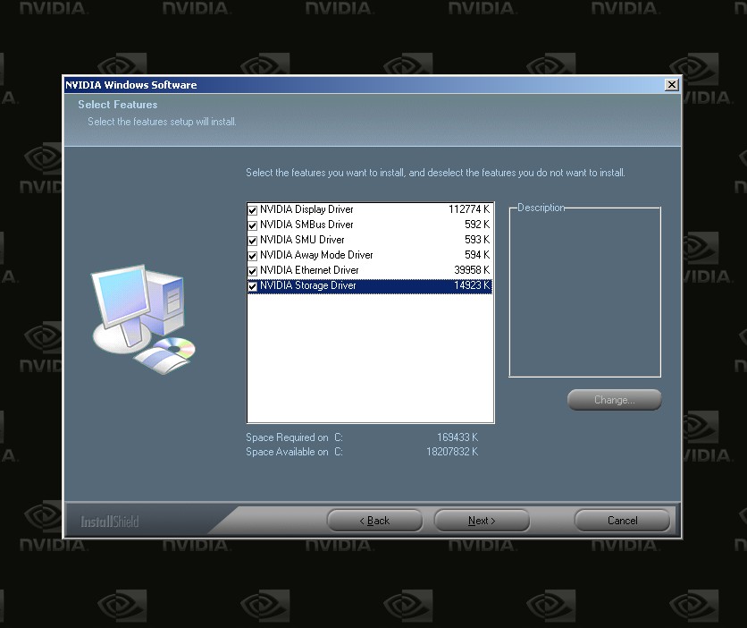

here are links to the Vista32 drivers I downloaded the driver install program, and started running it. I am stopped here (see attached) wondering which, if any, or all, of these do I select? None of the options seem to have anything to do with SATA drivers, unless it is the nvidia storage driver? tanstaafl.
#326333 - 24/09/2009 18:34
unless it is the nvidia storage driver Yup
#326334 - 24/09/2009 18:38
[Re: tman]
OK, I'll select that one, and deselect the others. Since I'm not having problems with them, I'm firmly of the opinion "If it ain't broke, don't fix it." What took so long to reply? It was nearly three minutes!  tanstaafl.

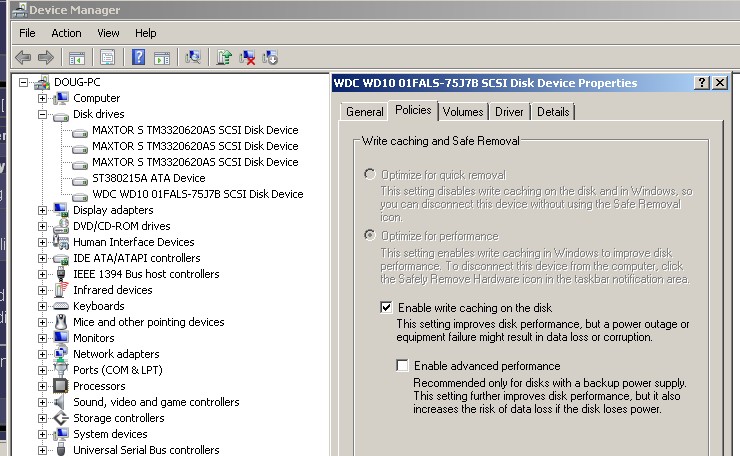

Open its properties and go to the "Policies" tab. There should be options there to select between "quick removal" and "performance". All of the hard drives look like the attached -- the options I want are all greyed out. Unchecking the one box that is accessible only unchecks the box, nothing else changes. tanstaafl.

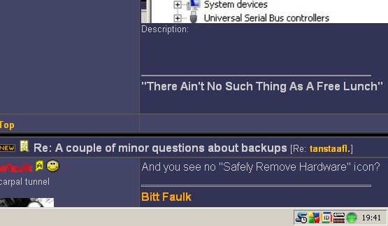

And you see no "Safely Remove Hardware" icon?
#326347 - 25/09/2009 00:46
[Re: wfaulk]
And you see no "Safely Remove Hardware" icon? See attached. That's all I have in my system tray. The icon on the far left is my Samsung Printer utility icon. The next two are AVG, then ClipTrak, then Active@. The "Safely Remove..." icon went away when I installed the new driver. tanstaafl.
#326348 - 25/09/2009 00:57
This sounds like a "did you try rebooting?" issue. If that doesn't work, try this at a command prompt: rundll32 shell32.dll,Control_RunDLL hotplug.dll Hopefully that's still the same under Vista.

In the screenshots above, was the drive powered on when Windows booted? I don't recall. Oh, wait... I had to reboot the system as part of the driver installation, and I did not have the external SATA drive powered up at the time. Just to be sure, just now I rebooted (with the external drive turned off) and ran a few tests. If I power up either of the two external USB hard drives, the "Safely Remove..." icon appears in the system tray, just like it used to do. Bit if I power up the external SATA drive, the icon does not appear. Even thouth the SATA drive shows in "My Computer" as drive G:, just as it is supposed to do, the "Remove Safely..." utility does not see the G: drive, only the H: USB drive. As soon as I safely remove the H: USB drive, the "Safely Remove..." icon disappears, never to be seen again until I connect another USB device such as my iPod, a flash drive, my camera, a card reader, or my external USB backup drives. Interestingly enough, I am pretty sure that my Safely Remove utility used to show and apparently allow me to unmount any drive in the system, including the four internal hard drives. (I never actually tried this...) Just how important is it to Safely Remove a drive if I am sure that it is not being written to? The only time the external SATA drive is active is when I am actually running my backup software. tanstaafl.
#326367 - 26/09/2009 00:58
Very. With it optimized for performance, there's no way to know what's actually been written to disk and what's still hanging around in memory.
Chances are that you'll be fine if you wait a good while after using the disk, but there's no way to be sure.
