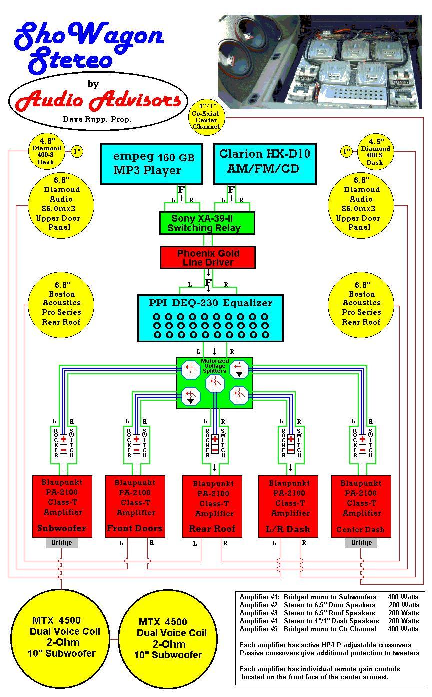

Hey guys:
I've got a car with the option of installing 6-speakers, but of course there are only 4 output channels from the empeg/Rio Car so what is the best way to add more speakers into the mix withour getting buzzing, humming or degrading sound quality? I'm thinking of using RCA Y-splitter cables on the front left & right outputs into two separate amplifiers in the trunk so that each lead can power a dedicated speaker. Is this the way the pros would do it?

You are correct. Currently I have a Sony eXplode amp with 4 outputs so I realize that I would either need to purchase one with 6 outputs or connect a second amp. But what I'm really wondering is whether the logistics of my theory is sound (no pun intended) and if splitting the signal from the empeg preamp is the least expensive and/or best way to add more speakers into the mix.

If you're going to go with a two amplifier setup, run the Left/Right front outputs from the empeg into one of the amps, the Left/Right rear outputs from the empeg into the second amp. Use one of the amps to run your subwoofers, the other amp to the four remaining speakers. Tune/tweak your amps (crossover settings, output gain, etc.) to match the speakers they are driving.

Many 4 Channel Amplifiers have a set of low pass filter outputs to drive a single channel or dual channel sub-woofer power amplifier. Those could be used as input for a Sub amplifier.
You configure the 4 channels as high pass and use the low pass outputs to run the Sub Amplifier.
Some 6 channel amplifiers like my McIntosh MC4000M have the high pass/low pass with amplifiers for all 6 drivers in one chassis. My previous MC440M had the same arrangement, just lower power.
It's the *only* way to get more speakers. smile
Here are some options for ways to handle more than four speakers in a system. Please note that it talks mostly about the extra pair of speakers being a subwoofer amp, but all the same techniques apply here:
Empeg FAQ: How do I run a subwoofer if the player doesn't have a subwoofer output?
#337354 - 20/09/2010 14:59 Re: (Six) 6-Speaker Installation Question [Re: tfabris]
I take that back. You can run two speakers off the same amplifier channel, provided that you do the correct impedance matching. There's a whole system for doing this sort of thing. Basically, you end up needing twice the amplifier power than what's shown on the box (since each channel is now driving two speakers instead of one), but it works. It's a common technique. Most likely covered in detail at one of these places (if any of those old links still work).
