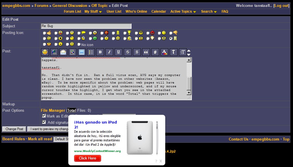

As mentioned in a previous post, I have been attacked by malware.
Edit4 -- More likely, it is my computer that is hacked, and not the bbs
I cleared my cache and deleted all my cookies, and I thought it might have fixed things, but it didn't.
I ran a full virus scan, AVG says my computer is clean. I have now seen the problem on other websites (Amazon, eBay).
To be more specific about the problem: web pages will have random words highlighted in yellow and underscored, and if my mouse cursor touches the highlight, I get what you see in the attached screenshot. In this case, it is the word "Total" (after File Manager) that triggered the popup. Sometimes the trigger is a word that I have typed, other times (as in the attached example) it is in the "boilerplate" of the page.
I really, really, don't want to nuke and repave to get rid of this thing. What should I do?

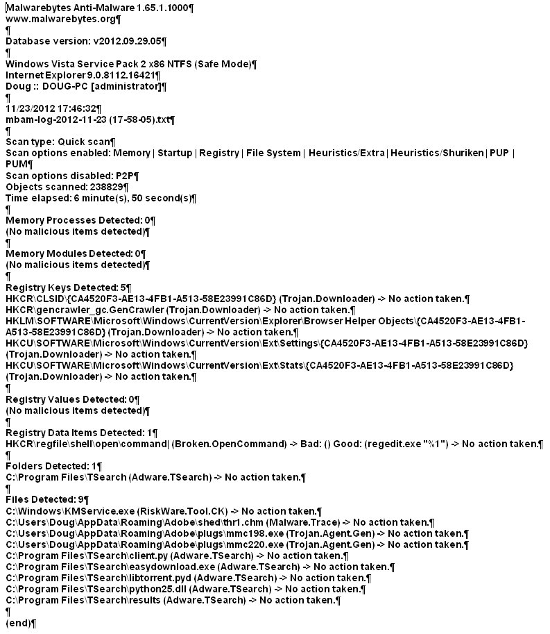

Attached is a screenshot of the Malware Bytes log taken (I think) before I clicked the Remove Malware button. After I did that, I re-ran the program and got the message that there was no malware found.
Incidentally, I found out why you recommend running Malware Bytes in safe mode... I ran it in "normal" mode the second time (when it found no malware) and on my next reboot Malware Bytes had enabled every single item in my Startup menu. I went through it and disabled all the things I want to keep but not have loaded on boot. Attached is a screenshot of my startup menu.
If anybody wants to look through those two screen shots (right-click and choose "View Image" to make them readable) and advise me of anything that doesn't look right, I'd appreciate it.

The TSearch thing is probably your problem.
Have a look in Add/Remove programs - it may be a simple case to remove it just there. Sometimes these uninstall nicely.
Also there's a number of Browser helper objects that look a bit dodgy.
Looks like about 3 or 4 different bits of malware (or just unwanted items) there. It's been a while since I've had to remove this sort of stuff, but AdAware was the tool I last used I think to automatically remove. I'm not sure what the best is these days. Just deleting the files and registry keys will probably be OK.
Let Malwarebytes do a clean up would be my recommendation. I'd remove basically most of the stuff. All of the registry keys I don't like. All but the first file look dodgy. The first looks like you're not running a genuine windows? That's a key server to bypass the windows authentication.
That's what I did, then I ran it again and it reported no malware found.

FWIW, I don't recall ever seeing Malwarebytes find a false-positive. I wouldn't worry about telling it to remove whatever it found.
