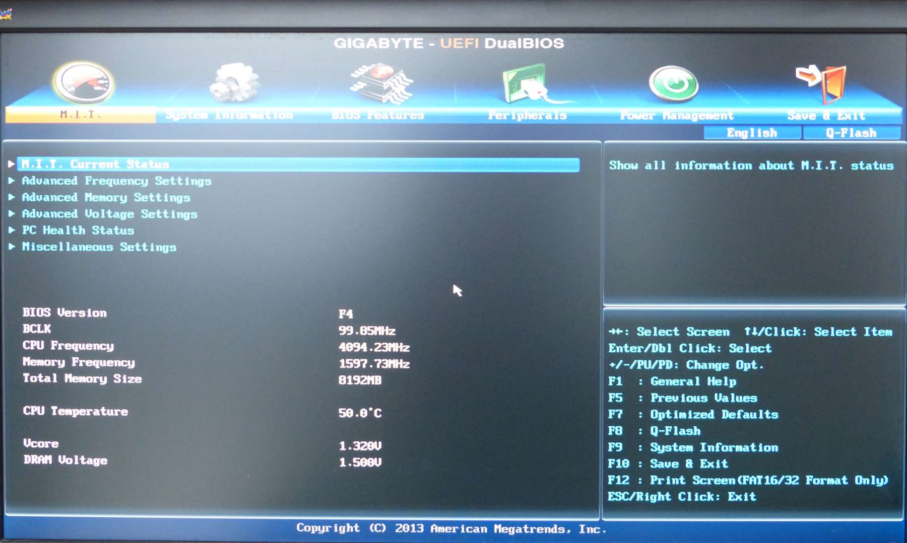

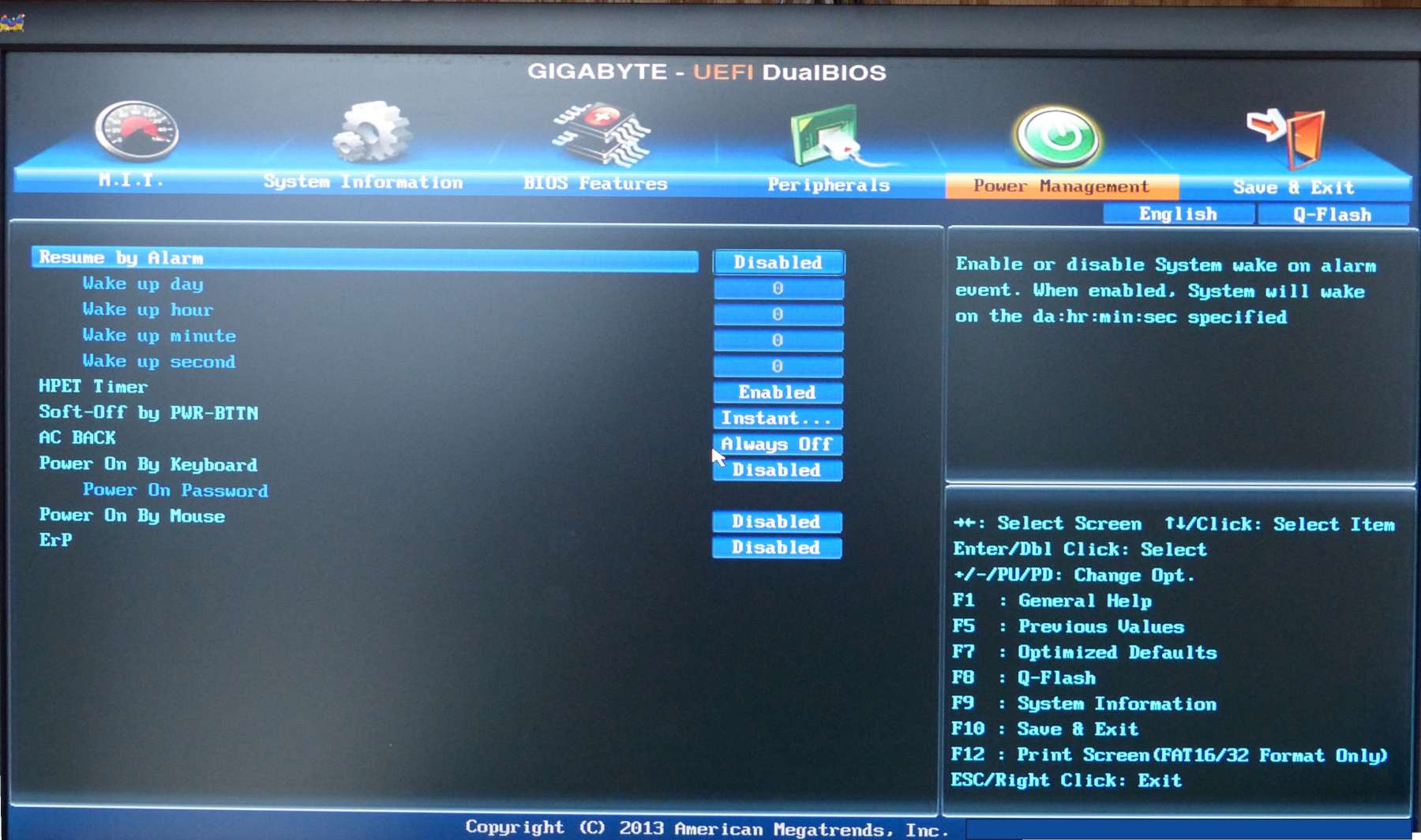

I just had a look at the BIOS setup... there must be two dozen acronyms and abbreviations I have no idea what they mean, quite possibly one of them had to do with that. There certainly wasn't anything that simply said "Turn off persistent USB Power". smile
I am not comfortable experimenting with BIOS settings that I don't understand!

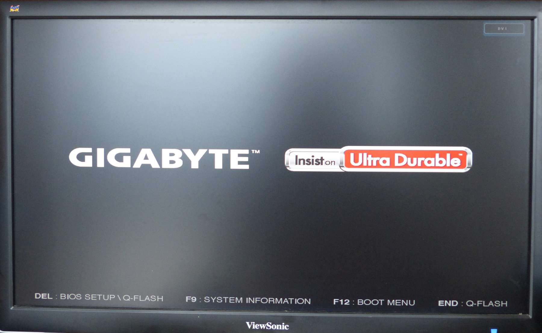

FWIW, on startup the screen flashes "AMD Gigabyte Ultra Durable", and the BIOS setup screen is quite pretty and well laid out, even if it is incomprehensible to me.

OK, update: I found that changing the ErP setting in the BIOS fixed the problem. [ErP refers to Energy related Products directive]. The default setting is "Disabled". When Enabled, the USB ports do indeed turn off when the computer is shut down.
However... there may be an undesirable side effect. I need to re-test this, but the one shutdown I did with ErP Enabled seemed to turn off the whole computer... permanently. It wouldn't power back up. After ten minutes of fiddling with the power switch, the power supply switch, plugging and unplugging the A/C power cord, suddenly there was a relay click from inside the computer and it came back up.
Since the only way I can get into the BIOS is to turn the computer off again... well, if you don't hear from me for a few days you'll know what happened. smirk

"Enable" the ErP thing. That should cause the USB ports to power down completely.
EDIT: Oh, I see you've already discovered that. Good!
Except it shouldn't give the grief that it does (mine doesn't).
Hunt for BIOS updates?
