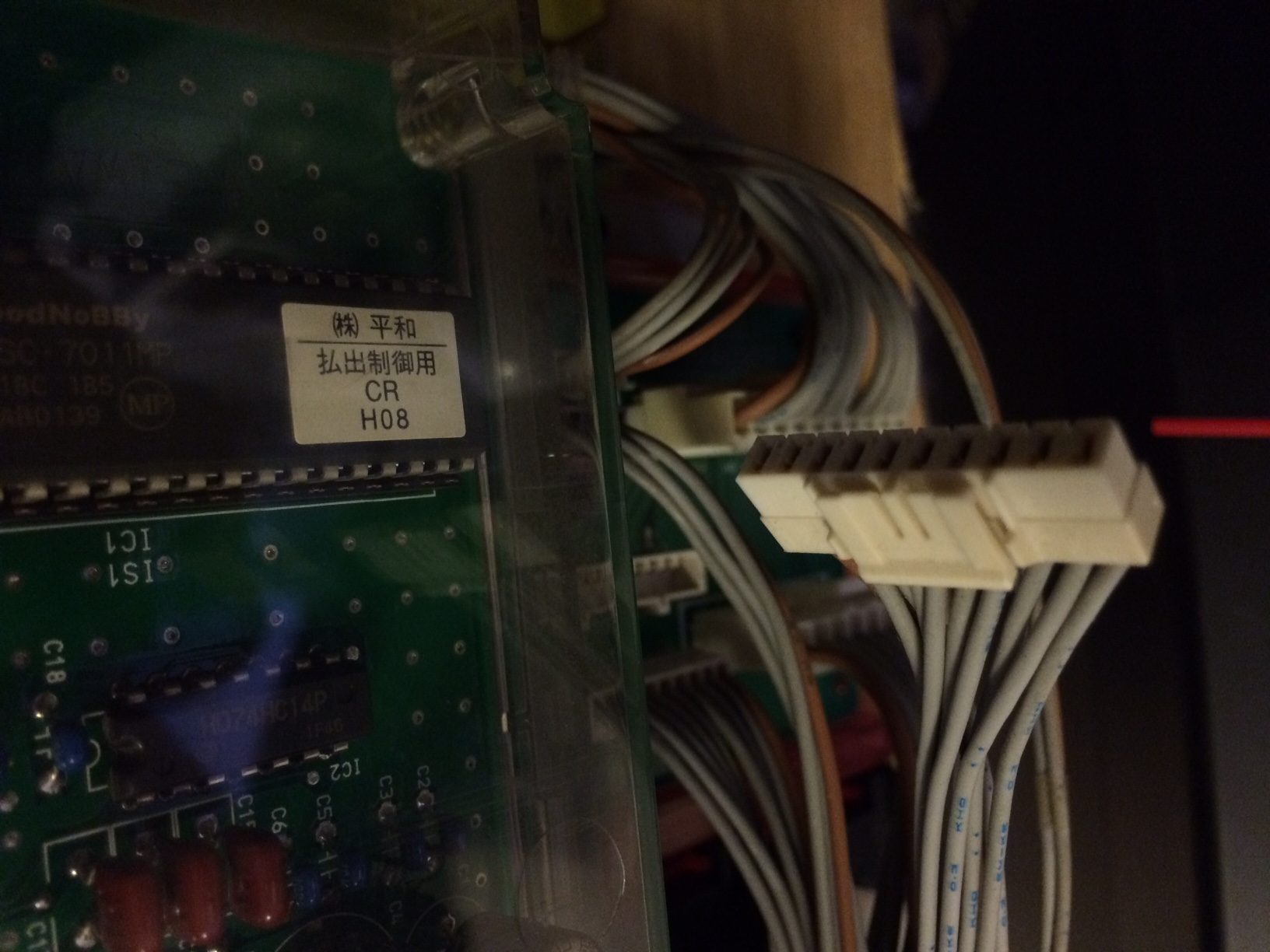

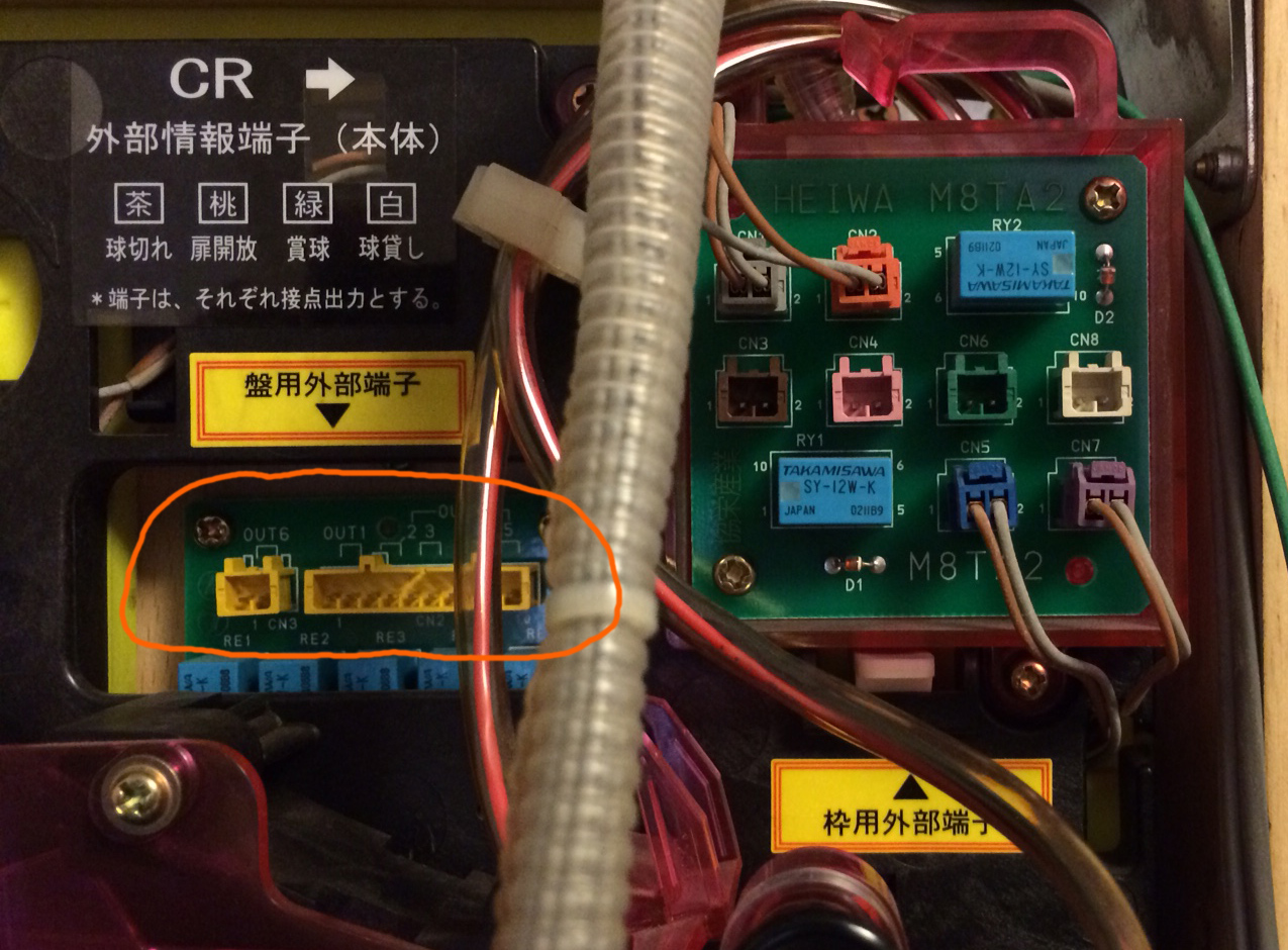

Long shot! Anyone have any idea at all how I might figure out what the other part to this connector is (highlighted in red circle)... It's from a Japanese Pachinko machine circa 2004 and would have been widely used at that time I think. Any clues ??? Edit - Pitch appears to be around 2.5mm Cheers Cris

Does it have any markings you might be able to see? Even the other brown/pink/green/white etc connectors on the other board might have some identifier and they look quite similar if not in the same family - it might get you a manufacturer for example. 2.5mm (2.54mm = 0.1" pitch) is not helpful since it's very very common. Probably a Japanese manufacturer too if the whole thing is made in Japan - Japanese stuff is frequently kept "in house". Looked at the big ones like Tyco, Molex, Phoenix etc
Surely there's some forum covering restoring, collecting these sorts of things? I didn't even know what one is but there'll be something or someone somewhere.

Yep, I've been to that forum, no one so far has the answer for me.
Searched Farnell and RS, nothing (wasn't really expecting it) and also trawled lots of Japanese websites selling special harnesses for my exact need, but so far no 10 way connectors like this.
There are connections like this between all the boards on this thing. I might have to try and find a junker and rip one off that. Or find something I can get a supply of and desolder this sucker and do my own thing !!! I'd prefer to keep the machine as is though.

Logo or name or any markings? Might be faintly moulded into the plastic.

Not a thing that I can see. Had a look with the Macro lens too.
There are larger connectors that look like scaled up versions of this, nothing on them either.
Looks like it might have to be a desolder and put something common in it's place !!!

Not replace, I am adding function to the machine that requires a connection from it to 6 of the terminals on this connector.
Getting this board out looks like it will be a total pain in the ass, so I want to avoid the soldering option if I can.
