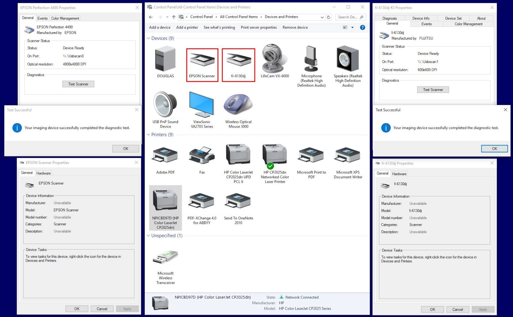

Yes, both scanners are listed, but there is no "Set as default" option that I can find.

I don't think it is a driver conflict problem. The scanners show themselves to be on separate USB ports, and both scanners pass the Windows diagnostic test. See the screenshot.
Operationally, the problem seems to be that if the EpsonScan UI software is installed, it takes over any and all scanning operations, that is, it won't let me use the Fujitsu scanner even though I start out using the Fujitsu's software. As soon as I tell the Fujitsu software to scan, it brings up the EpsonScan software and the job goes to the Epson.
If I then go to Devices and Printers and Uninstall the EpsonScan software, the Fujitsu works properly.
I went so far as to rename the escndv.exe program, and the damn thing still ran. The only way I can find to stop it is to do a full Epson uninstall.

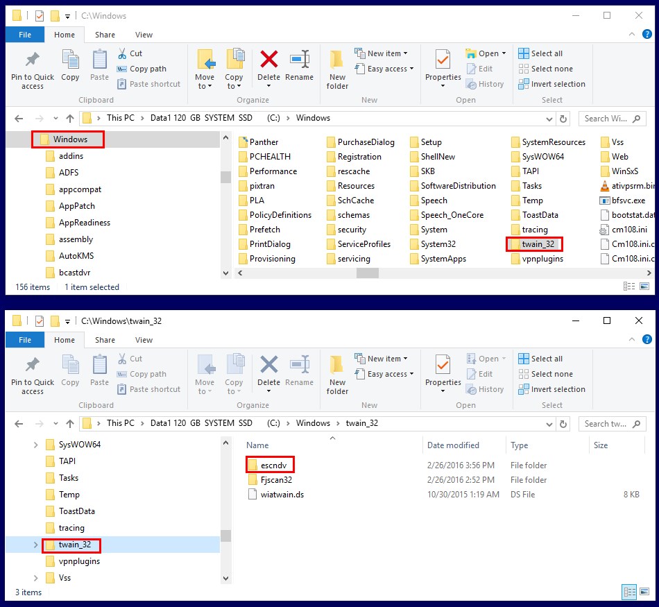

If I rename the directory containing the Twain driver for the Epson scanner, then everything works (except for the Epson scanner, of course. smile
So, I wrote a batch file that will rename the escndv directory to XXescndv, and another one to name it back. The batch files work like a charm... as long as I am in the C:\Windows\Twain_32 directory with an administrator command prompt.
