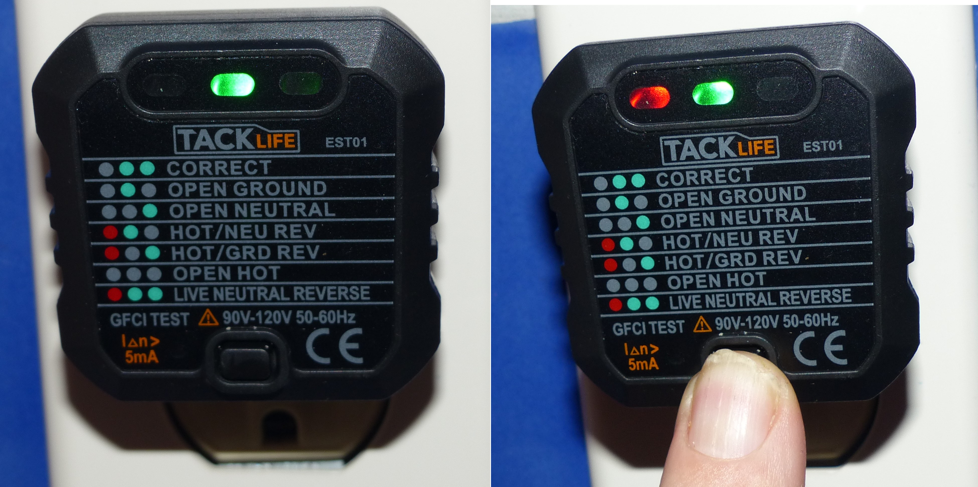

#370712 - 22/03/2018 23:49 Re: Building Wiring Fault [Re: tanstaafl.]
What does this mean?
Here is what the clever little device had to say. I got the same readings from different outlets in different parts of the house, except for one room which shows two green lights and no red whether or not the button is pressed.
Attached are two files, one of the line checker in action, and another of the very detailed instruction manual which I had to scan in at 600 dpi and then quadruple the dimensions of the image to make the text large enough to read.
So now the question is: What is my next step?

#370713 - 23/03/2018 02:50 Re: Building Wiring Fault [Re: tanstaafl.]
Open ground, as I initially guessed.
The button isn't useful unless you're testing a GFCI outlet, so just ignore it.
I'm no electrician, but as I understand it, you'll need to run a ground wire from each outlet that you want to be properly grounded to your electrical panel. Then inside the panel, If I understand correctly, the ground bus should be bonded to the neutral bus, and also connected via a grounding wire to a 8 ft copper rod that's driven into the ground. Any electrician should know what to do and would be incredibly cheap by US standards. The hairy part is what's involved in running that wire from point A to point B.
Also, any outlet that you don't want to run a ground wire for should be switched back to a two prong outlet or labeled so that people don't mistake it for a grounded outlet.
#370714 - 23/03/2018 02:58 Re: Building Wiring Fault [Re: tanstaafl.]
Attached are two files, one of the line checker in action ...
I did not look at the instructions, but I have used similar testers many times.
First note: The GFI fault tester button cannot perform its test function unless there is a ground circuit connected to the outlet. Without a ground, the test button just creates an oddball light pattern on the tester.
The single green light (when the test button is not pressed) indicates the outlet has AC power, but there is no ground connection to the outlet. If there was a ground connection, a second light would illuminate.
As anticipated, it appears your house is wired without grounding to the outlets. This is also what the UPS ‘wiring fault’ indicator is complaining about.
Next step? Well, if you wish to avail yourself of the additional safety and safeguards that a ground connection offers, somehow a proper ground wire needs to connect between the green screw on the back of the wall receptacle, and to an actual electrical ground point.
How this might be done would be specific to your house configuration, and to what the local electrical codes allow.
