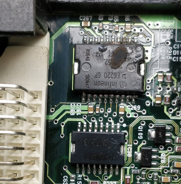

In addition to empeg players, I also sometimes repair automotive ECUs (Engine Control Unit, aka "the car's computer").
Usually it's just a matter of somehow opening up the factory sealed enclosure (if possible) and then looking for obviously fried components. Replace the baddies and eight times out of ten it works again.

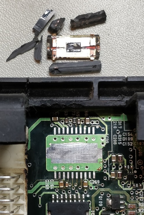

The current one I'm looking at had an obvious failure point, in a 20-pin driver chip (CAD$8 from Digikey.ca). But getting it off the board was a real tug of war. In the end I just cut it into pieces, and pried those off to reveal the solid copper heatsink base of the chip, soldered to a very large pad on the board under the chip.
The soldering iron was inadequate for removal, so I applied heat from a small butane torch directly to the copper remnant of the chip, and it came away cleanly.

Description: Spot the blown chip!
Description: Removed. With fuss.
